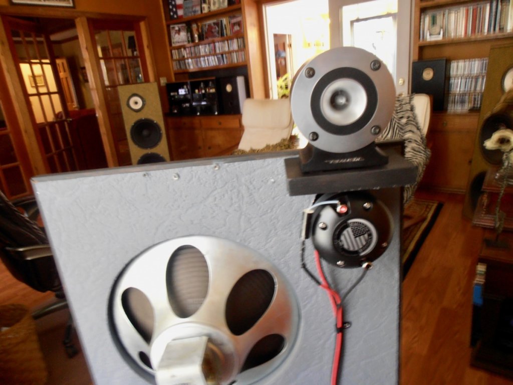

« Reply #14 on: 25 Sep 2018, 09:32 pm »
With the Zenith OB's I use a closed rear firing tweeter to compensate for the closed front firing tweeter.
Interesting
How are they wired (series/parallel) and what does it do to the impedance and sensitivity. Also are there any phasing issues?

Poultrygeist
Re: Dipole tweeters
« Reply #19 on: 26 Sep 2018, 09:20 am »
Those opposed tweeters are wired parallel with reverse phase on the rear tweeters.
