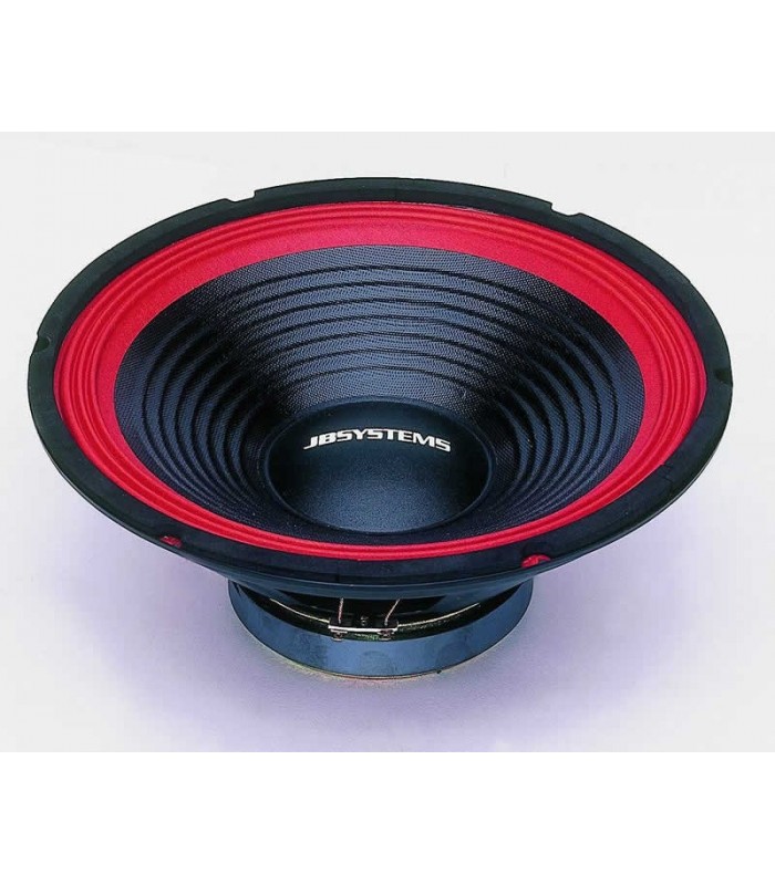

  • The JB Systems SP15/250 has been suggested in this thread and may be a good inexpensive option for European experimenters. For example (BE).

My few cents on a OB sub driver which I'm using in a Ripol setup with 4x15".
Can only say they play magnificent and go easily down to 20 hz. Applying DSP correction and mainly use them up 80 hz. In my system since 2011.
JB Systems SP15/250 @ 40,- Euro's a piece.
Fs: 31 Hz
Vas: 238 l
Qms: 5,9
Qes: 1,3
Qts: 1,08
Sd: 983,7 cm2
BR
