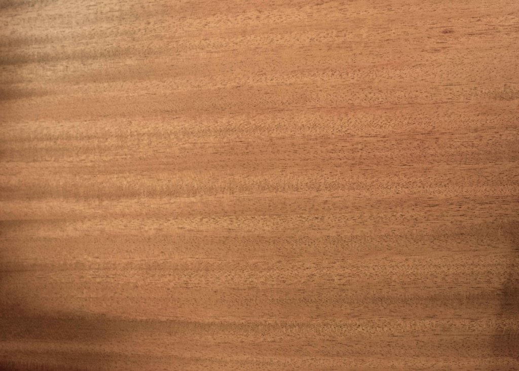

The veneer the client chose is a quartersawn ribbon stripped African Mahogany.
I am almost done with the veneering, just have the tops of the 4 cabinets to do. Hopefully I'll get that done tomorrow. Then I have to make up samples of different finishing options. I'm thinking of doing 4 samples. One left natural, just a clear sealer and lacquer topcoat. A second will be sealed, dyed with a red mahogany dye then topcoated. The third will be a brown mahogany dye and topcoat. Fourth is more complex: sealer, burgundy dye, dark brown grain filler, sealer, then topcoat.
Any other ideas for a finishing schedule that will yield the classic Mahogany look?

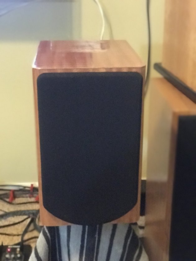

Danish Oil is a pretty nice finish. It does take several coats. It leaves a nice natural finish with the grain still showing. I like it. I used Watco Danish Oil (fruitwood) on one of my Folsom amps over Canary wood . The photo doesn't do it justice. It's more of a nice satin finish, not the shiny finish the flash created in the photo.

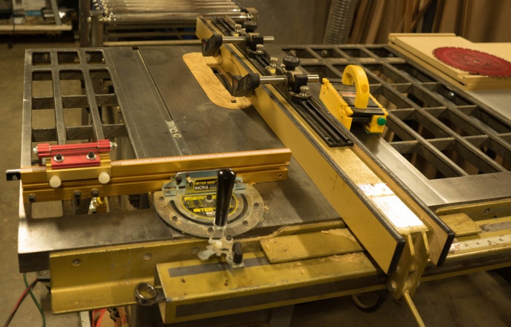

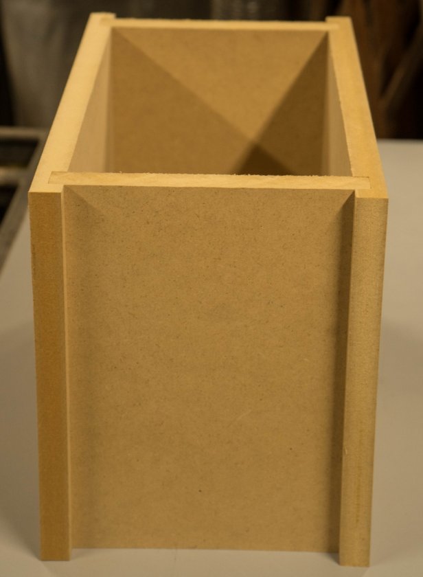

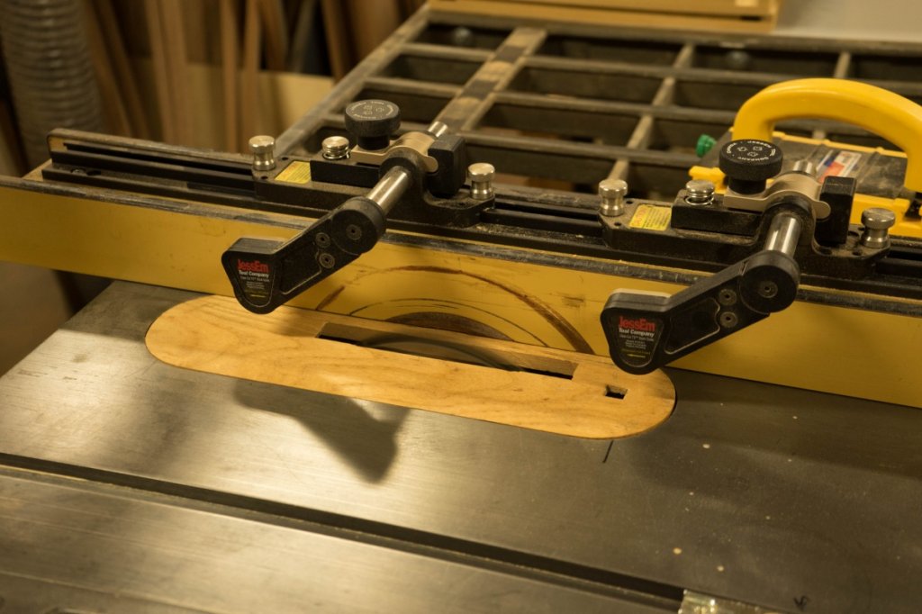

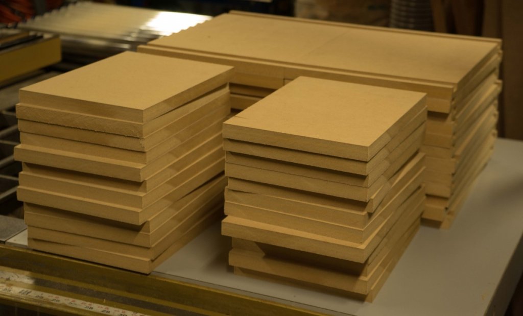

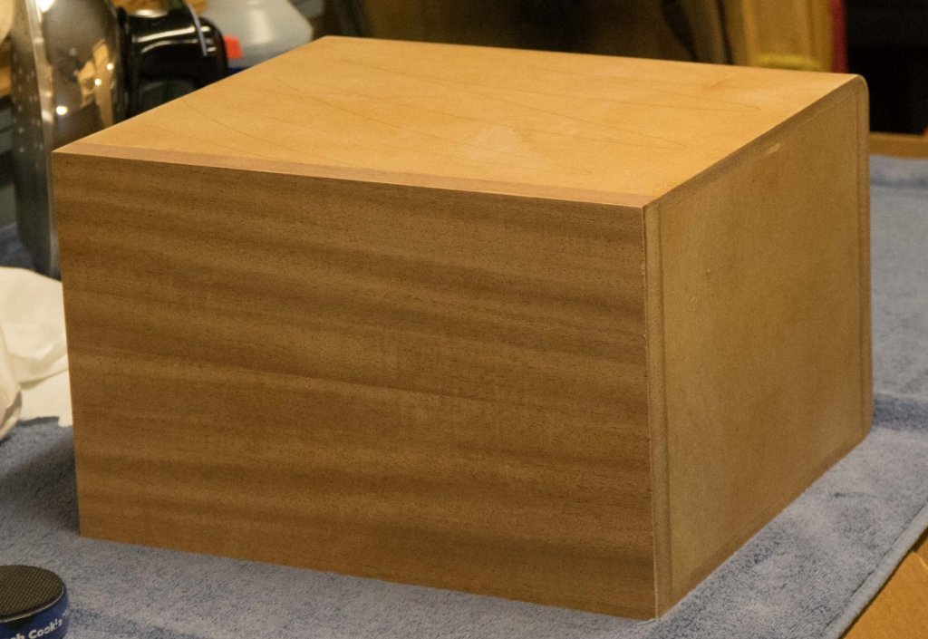

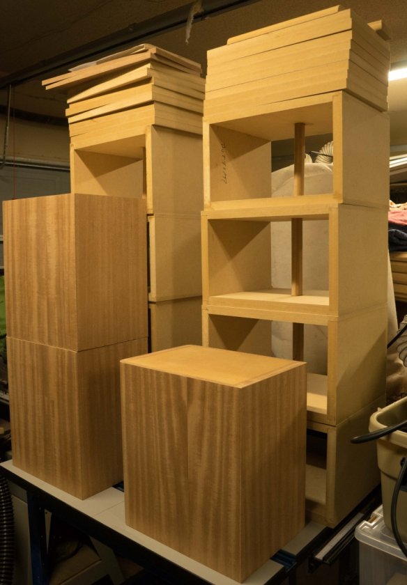

For this build I decided to do the carcasses a little differently. Instead of butt joints, I cut dadoes into the sides then flush trimmed the ends after glue up.
Here's the dado setup
Here is the stack of carcass parts with the dadoes cut
Here's a carcass glued up before flush trimming

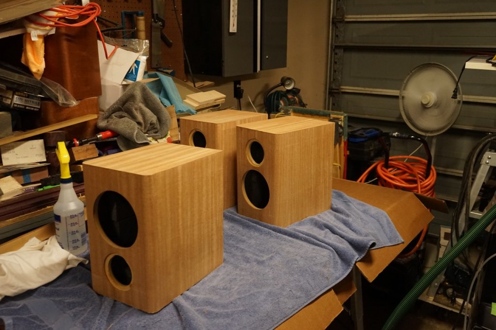

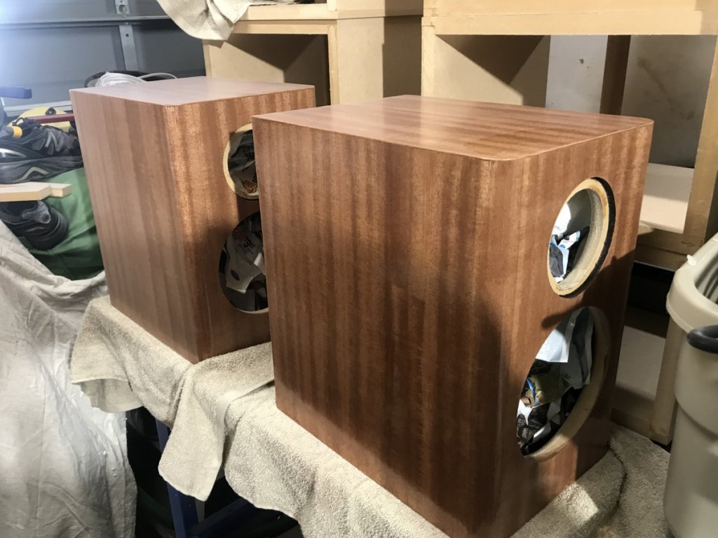

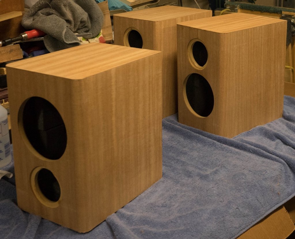

I am currently building two pairs of these. They are both getting the same veneer, African ribbon stripped Mahogany. First I veneer the back
Then I wrap a single piece around the front and sides. Those are 4 more pairs of carcasses glued up behind the speakers.
Finally I add the top and bottom pieces and cut out the veneer over the driver openings.
Next up will be pics of the color samples for finishing options.
Mike

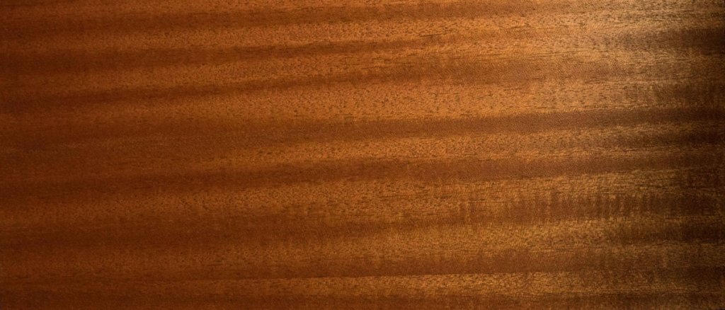

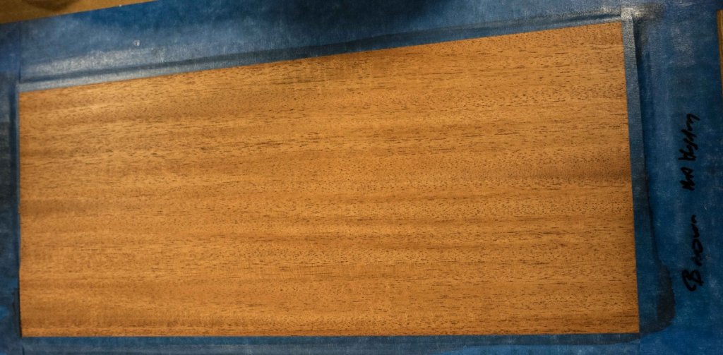

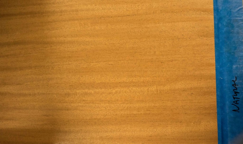

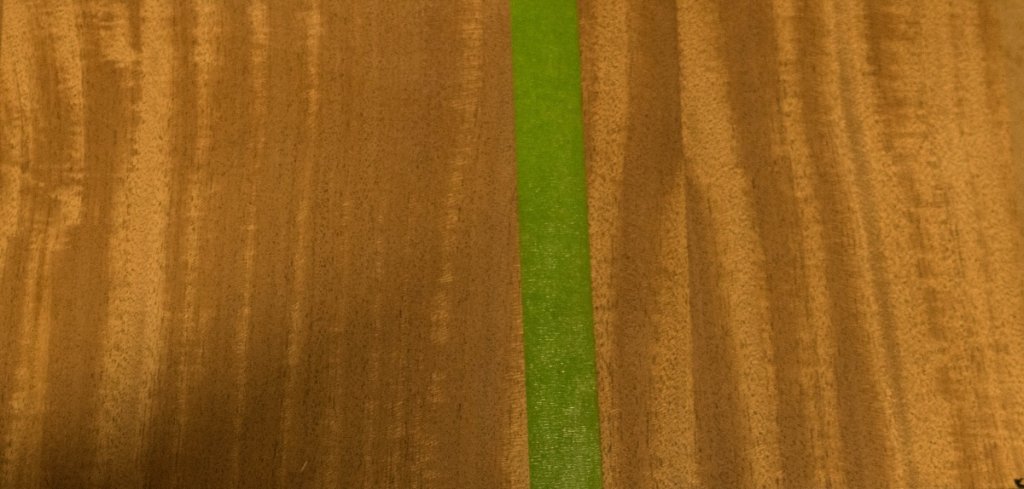

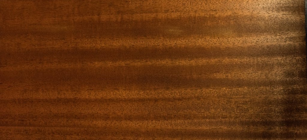

Here are some pics of the color samples that turned out at least somewhat decent. My camera work still leaves much to be desired.
First up is left natural with a sealer coat applied. The sealer coat was left full strength. It probably should have been diluted 50%, especially since I wiped it on rather than spraying. I wasn't going to break out the turbine and spray gun for the small amount of area of the samples.
This one has the seal coat and red mahogany dye then dark brown grain filler
Next is sealer then brown mahogany dye and dark brown grain filler
This one is left natural, no seal coat, then dark brown grain filler. Ignore the green tape. I initially planned on doing something different with each side but decided not to.
This one is red mahogany Danish oil with no grain filler
Finally this one is red mahogany Danish oil with dark brown grain filler
Mike

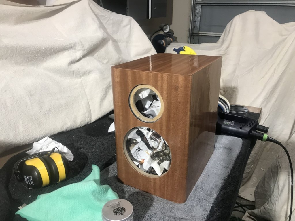

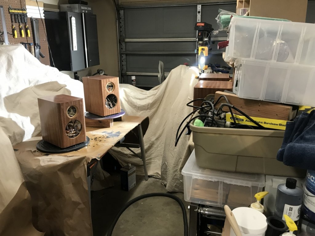

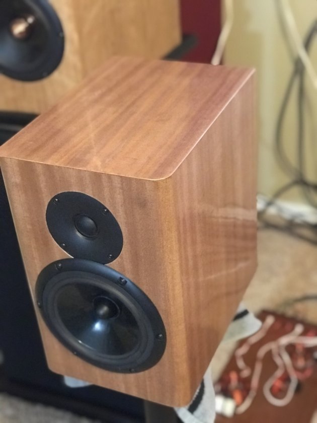

I finally got the contracted pair finished in time for Christmas.

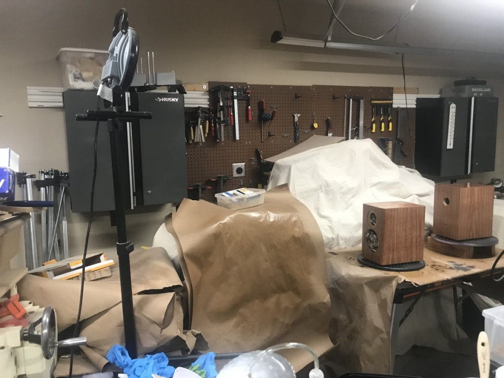

Cabinets veneered

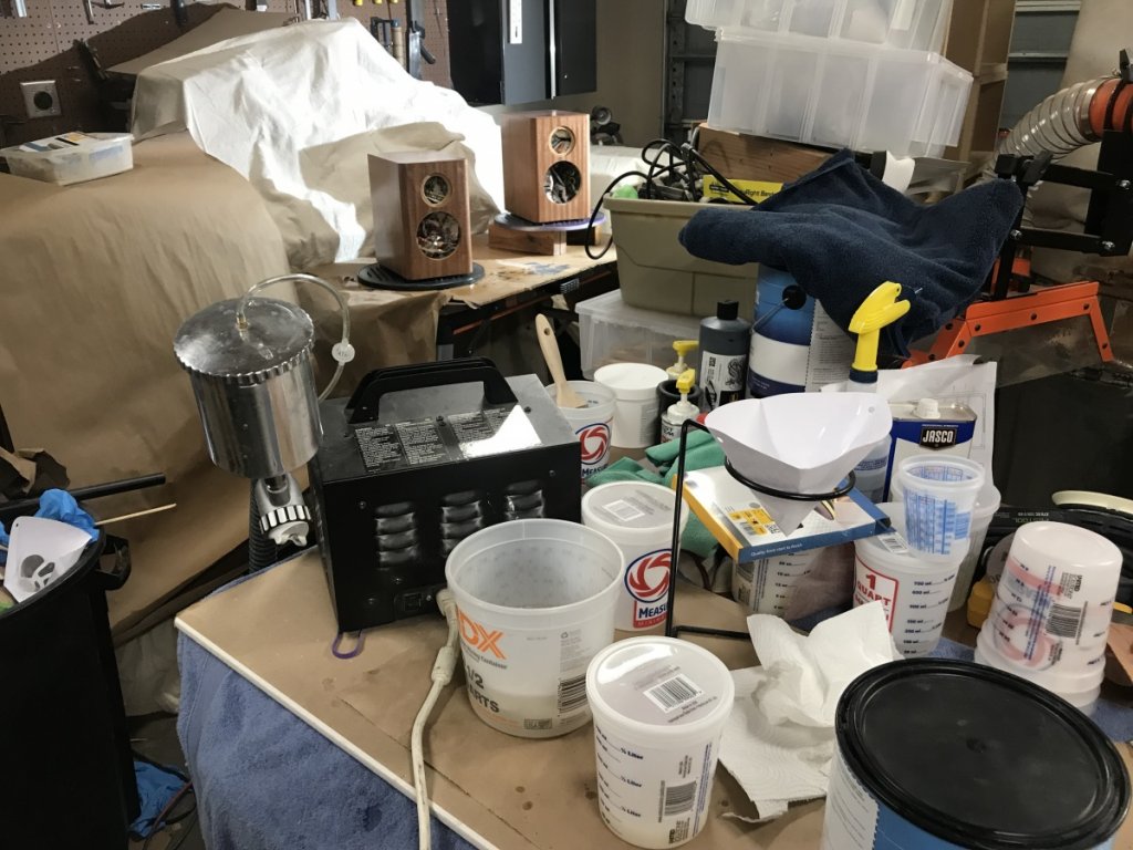

Getting set up to spray finish
My spray booth for this project  :?

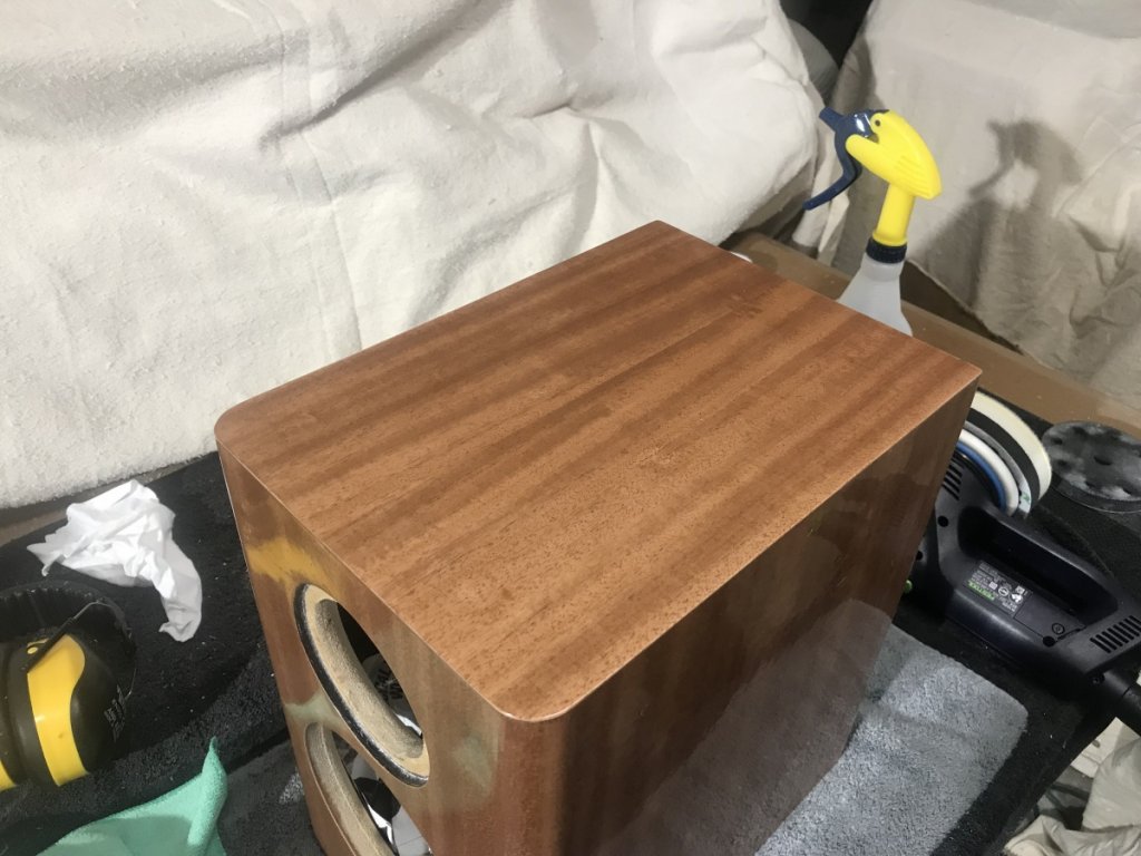

9 coats of Target Coatings EM7000 waterborne lacquer later ...
After sanding flat, polishing, and wiring up ...
Mike

She liked them. I didn't get the finish sanded completely flat. There were a few shiny specks here and there left but I was afraid of cutting too much and going into the veneer. The result is a tiny bit of orange peel here and there if you look deeply into the finish with the light at the right angle. She actually liked this effect because she felt it proves they were hand built and finished.
I had built a second pair of cabinets along side these and gave her the best two. I have since gone back and sanded the other two back much further using P600. I have them sanded to where there are no shiny spots at all. However, when I run my finger over the surface I can feel a waviness to the finish. I'm not sure what is going on with this. I used a hard sanding pad on my Festool RO125 sander so I expected the surface to be flat, not wavy.
These are the first Encores I have heard with the old stock PC board crossover (she has had the kit a couple years). I have to say they sounded pretty darn good. Bass response was solid down below 40Hz but I have a huge peak (+18dB) at 40Hz in this room which I'm sure contributed to the extended low end output of the Encores.
I need to figure out how to get the finishing done correctly.  I can watch all the YouTube videos and DVD courses I want but without someone who knows what they are doing to critique as I am going I'm flying partially blind.
Anybody have any idea why a lacquer finish would feel wavy after sanding down and what to try next?
