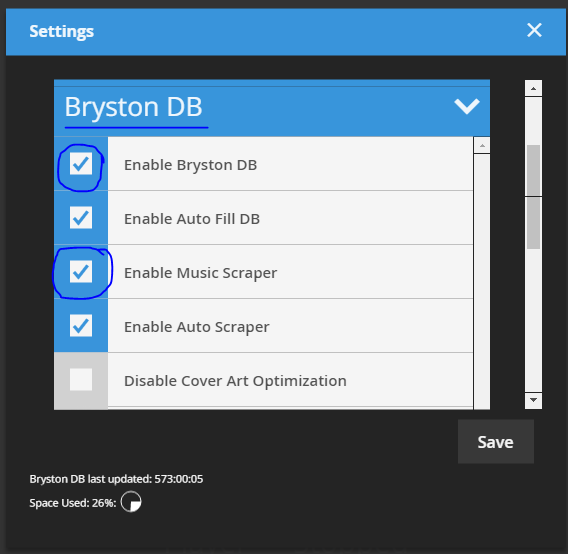

enable auto fill db isn't required, it simply tries to fill in missing information so it may help but will slow down the build process as it attempts to identify missing tag data
Chris

« Reply #9 on: 9 Sep 2018, 08:34 pm »
mine looks different
I don't know how to follow that instruction  :roll: -

You'll need to do a factory reset, if you don't want to loose your settings/playlists copy the contents of the network share "user" hosted by the BDP to your computer and after the factory reset copy them back and restart the bdp.
Chris

Thanks, Chris, enabling the Scraper [what is that?] options has brought the Infinity curves into view. So solved for me.
D
