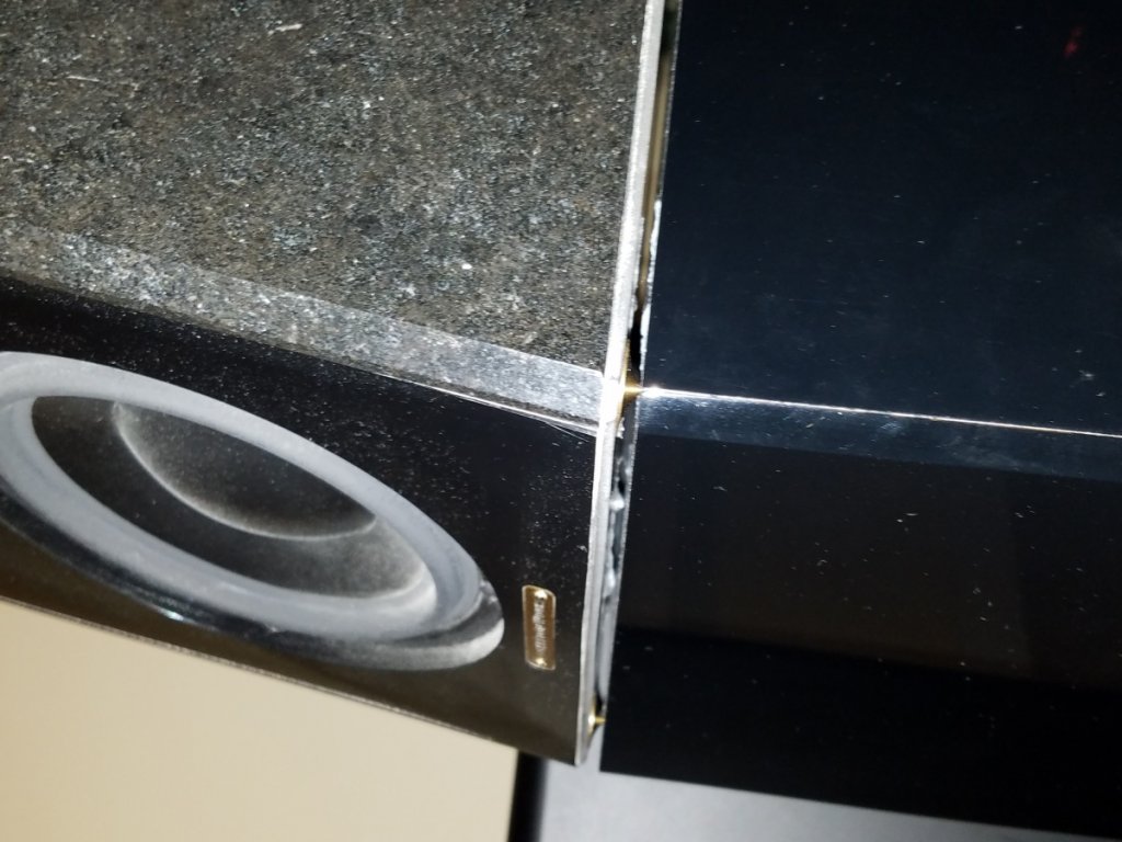

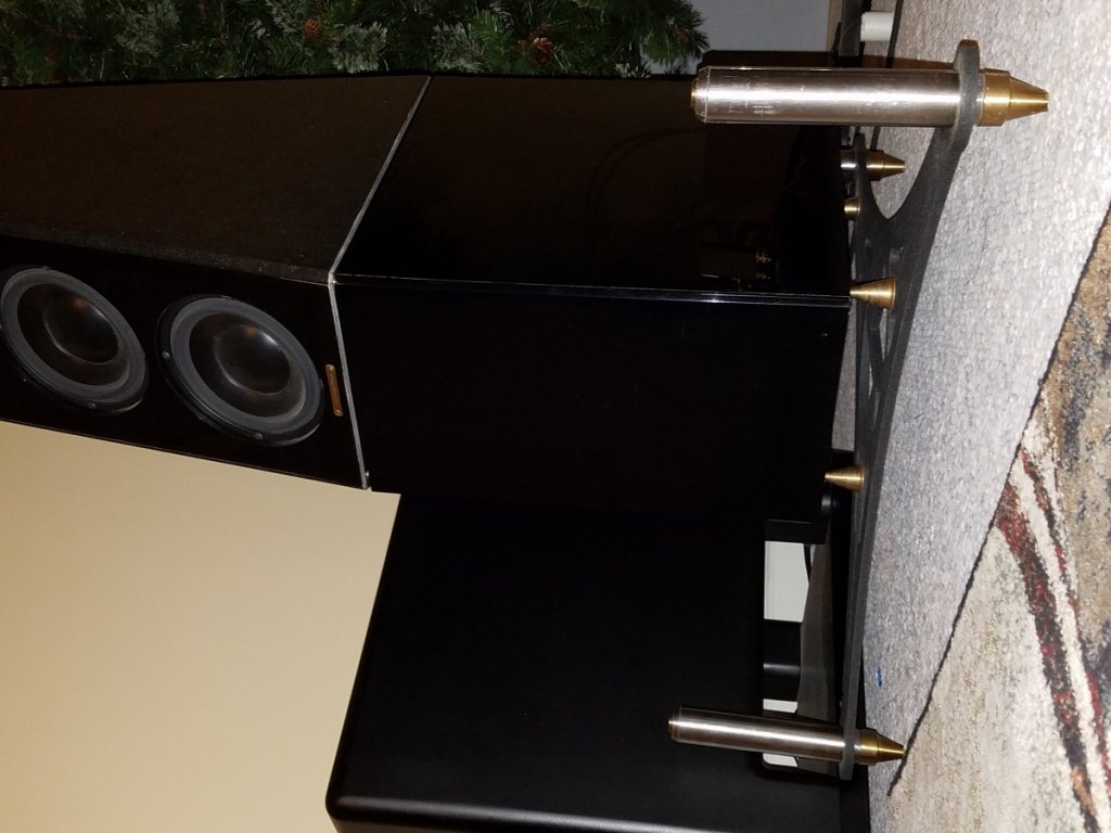

"Tilting?" ... oh my ... oh no ... not me ...
go
As you can see, my speakers, much like my financial status, teeter on the brink of destruction. The bases are delicately balanced (tri-points) on their stands, while the top portion (cabinet with drivers) are separated from their integral box stands, and are also delicately balanced (tri-points). I am afraid any tilting, even careful, would send them tumbling.  :lol:

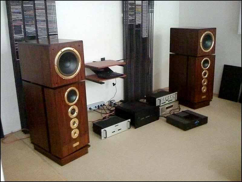

Thanks Rockadanny
When xover causes this restriction the manufacturer usually informs in the suited positioning cabinet tips the height indicated for tweeter.
Seems Dynaudio have no this prob:

« Reply #14 on: 31 Aug 2018, 11:36 am »
Thanks FullRangeMan. Those speakers certainly speak to your point. Wow.  :o
