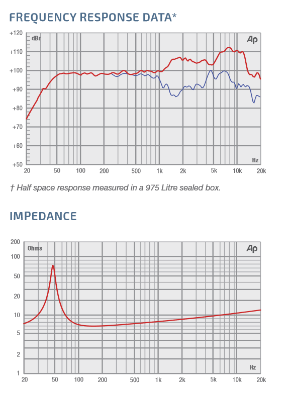

About some 15" : any Opinion about some Fane ?  SO15-400LF or FC152F01 ?
https://www.toutlehautparleur.com/media/catalog/product/datasheet/fane/SO15-400LF-8.pdf
https://www.fane-international.com/downloads/Fane-FC152F01-DS280417.pdf
About some 12" , only this one, and doesnt seems good as the 15"
https://www.fane-international.com/downloads/Fane-Sovereign-12250TC-DS240316.pdf
I could buy  a pair of Fane 14 400LF for 200€ ... ?
