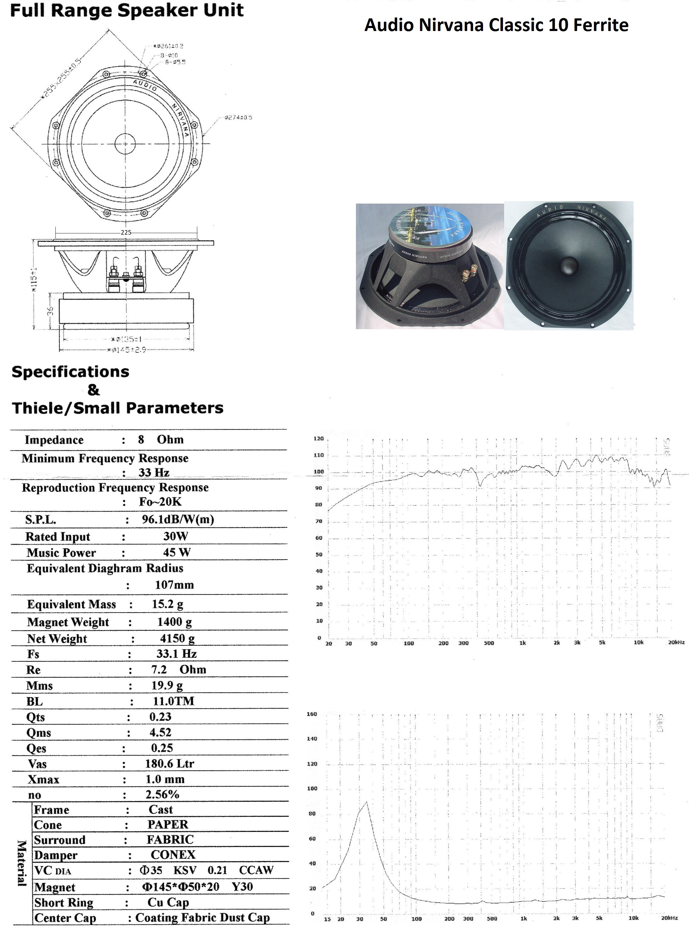

I did not suggest the B200 to OB why 120Hz is still bass freq.
Maybe this FR can sound good in 120Hz OB:
http://www.commonsenseaudio.com/an10classicspecs.jpg
It was positively tested here as OB full band no sub:
http://www.glowinthedarkaudio.com/audionirvana.html
