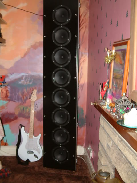

Years ago Paul Hynes made an OBLA entirely of B200s.
