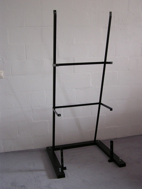

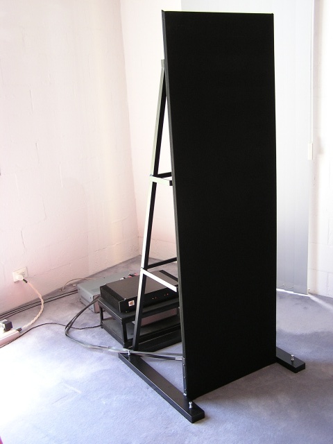

« Reply #10 on: 6 Jan 2005, 01:17 am »
Thanks, ChairGuy,
Ive uploaded into the Gallery some pictures of the stands I had made up for my IIIAs but I can't figure out how to get the URL.  They are on p36 of the Gallery.
The stands bolt to the back of the panels.
Regards,
Andy[/img]

« Reply #11 on: 6 Jan 2005, 02:53 am »
You did a very nice job on those stands.  Great work! 8)
