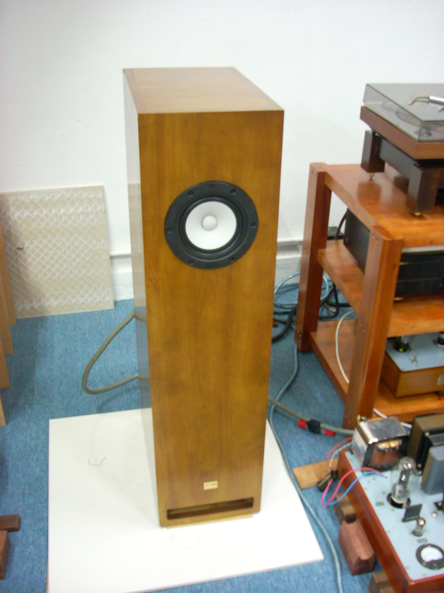

I bought a set of the WR125S 4.5 inch full range drivers.
Just completed these, and wanted to mention that I am SO happy with the sound that these little buggers create in my room.
I first received my set of these, during the October sale that CSS (www.creativesound.ca) had, during their initial run.  I boxed them up in cardboard, to break them in, and get a sense for what they could do.  They sounded surprisingly good, given that the enclosure was trash. I gave them about 100 hours of break in, happily listening to those cardboard boxes, although the bass was lacking, and the boxes droned pretty bad…
I sat down at my PC with WinISD, and began looking at plots.  Waste of time in the end, the 0.3 foot enclosure that is recommended, ported to anywhere between 55 and 70Hz is great for this driver.
Conspired to build my own narrow baffle, deep enclosure, since that shape floats my canoe.  Spent the last couple of weeks measuring, planning, and cutting some 0.75 inch mdf and Baltic Birch plywood panels.  Then spent some evenings and AM's gluing and clamping.  Then came the fun with the silicone, and leaving my powder room fan running all night...
Long story short, the boxes are completed (the exterior finish will have to wait since it is a little too chilly in the garage for painting at the moment in Toronto, ON, Canada) and are again running in my basement, in my present system.

Pics for those interested - please forgive the "unfinished" nature of the speakers - it is too cold out right now to put any real finish on them, so they will remain "natural" for the next couple of months.
In the Spring I will route off the corners of the boxes, and apply a finish.
I am in the process of planning a matching center channel, since my Totems (seen in the final shot) are not video shielded, and foul my old school CRT Vega TV...

Looks nice, Mark. More real to me than those other  "things" on top of your TV. Just kidding, I bet they are bilingual speakers.
