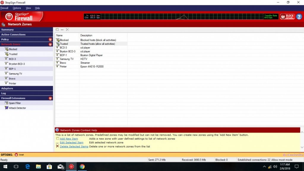

Mag

Okay with my firewall I have to 'add new item' to network zone. Then under 'general tab' BDP-3, digital player. Then under 'hosts' type in the IP Addresses. On my BDP-1 the IP Address ranges from 192.168.0.100, 192.168.0.101, 192.168.0.102, 192.168.0.103. Host name IP address.
Hope this helps, may have to reboot router afterward.

Mag
Re: BDP-3--newbie question--connecting it to a wireless network
« Reply #14 on: 6 Feb 2018, 07:49 am »
Below are screen shots of my computer. The first is my network, note BDP-1 is below 'Trusted' which was an added item. I then reconfigured the Firewall. Next is the BDP with the IP addressed, note 192.168.0.104 is not listed.
Next is the screen shot of IP address in Google browser, 192.168.0.104
