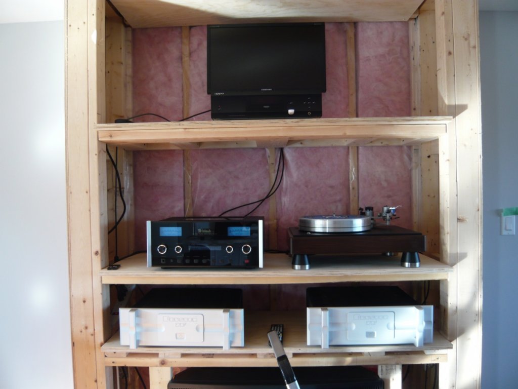

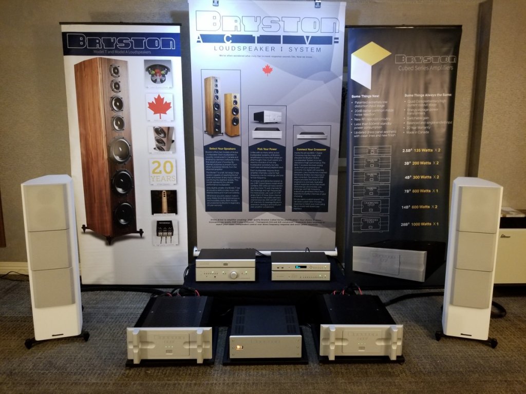

Great plan
Can i overdrive the middle T`s with the 7b3
Put the blue in the 7b3 to mach the blue in the mac and oppo
very nice
Thankyou Bryston

Hi
No problem with the 7B's and the Middles - I have that setup in one of my rooms at home.
james

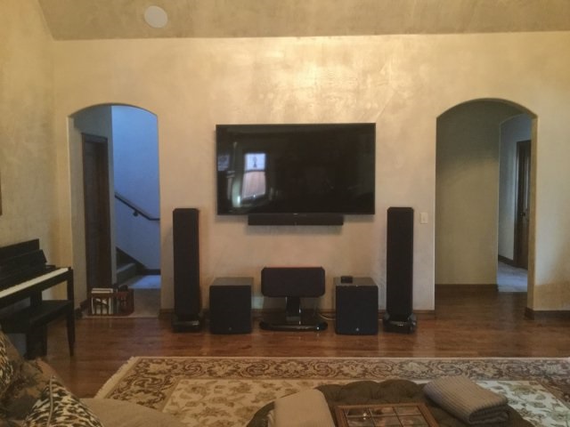

Lucky! The 7B3's must sound amazing with the Middles. I'm still running 4B2 with mini's - and love it!
But just switched houses, and my new listening room needs some work.
Tons of reflective surfaces. No carpet, or drapes yet. Only 15 feet from wall to wall - and the mini's are placed 3 feet from the back wall. So, the speakers are about 11 feet from my ears.   The other dimension in this rectangle room is about about 30 feet in length.
Any recommendations for damping James?
TJ

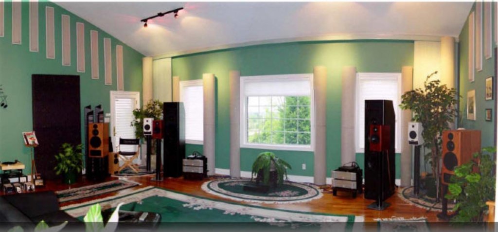

Hi Gary,
I have used a lot of room absorptive acoustic control (Tube Traps, Foam products etc.) in my sound rooms over the years and in studios and I use to be a real advocate of this approach.
But since speakers have been getting better and better at uniform Polar response on and off axis I have changed my mind.  I always felt heavily damped rooms sounded very unnatural to me but lived with it because the image characteristics of the system generally improved. But put me in the dispersion camp now rather than the absorption camp.
Here's a shot of one of my rooms where I had a lot of acoustical treatment.
james

Hi James,
That is a beautiful room. You are right, lots of absorption material there. You must have a really nice home. Love the flooring and carpets.  Come to think of it, reminds me a lot of my downstairs living room.  After buying the Meyer Sound system, I moved my Revels downstairs. Pic to follow. Note the flooring and rug. We think alike.  :D
Gary
Gary L
Re: Just switch out my amps to 7b3,looking at middle t
« Reply #10 on: 10 Nov 2017, 08:56 pm »
Hmmm. Pic upside down. Oh well.

james - nice room. those IB2's look awfully nice. dream speaker of mine. someday baby.
Gary - i'm with you man. i just added a rug, some thick drapes, and another couch. the PMC 22's sounds even sweeter. i'll hook up the mini's tomorrow and give the girls another run.  thinking of getting a few panels too.
here's a pic before the additional damping materials.
