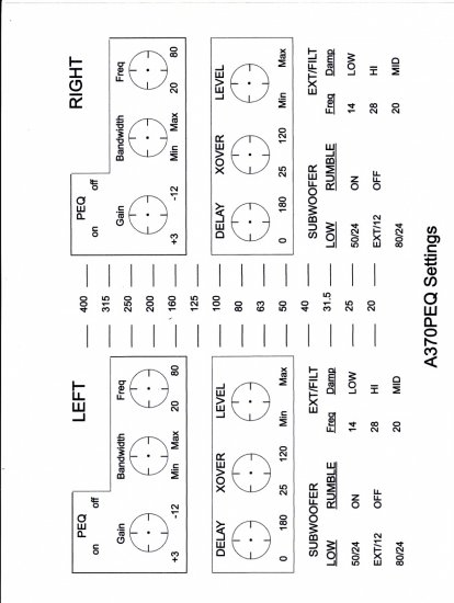

 Here's a copy of the diagram.

Tyson, thanks for the info on the sub setting, gave it a try and picked up some more impact.  :thumb:

I spent about an hour fooling with it this afternoon and wound up turning the bass up a bit.  As Throwback mentions above, there are a jillion variables.  In addition to the sub amp adjustments, I am running both subs off a DSpeaker Anti-Mode 2.0 Dual Core which gives me a huge range of DSP adjustments which I have never used.  I have noticed for the last few years that after I set sub levels using an Omni-Mic, I wind up turning the sub down to a level I prefer for listening.  Looking at my freq response today, I see the peak is at 100 Hz.  I will try to use the DSP to lower this while leaving the area around 50 Hz unchanged.  I am hoping this will eliminate the slight boominess in vocals I get if I do not turn the bass level below what is measured as flat.  We'll see what happens.  I do notice that with the bass turned up from my normal level, I get a much improved "floor" to everything.  All I am missing is that"WHOOMP" when a full orchestra really hits it.  That is not boominess - it is how a live orchestra in a nice hall (Cleveland's Severance is the one I am familiar with) really sounds.  It can rock you in your seat -  in a goood way. I appreciate all the help.  I also plan to try a better DAC at some time to see if that is helpful.  But I am now 95% there.  Thanks.
