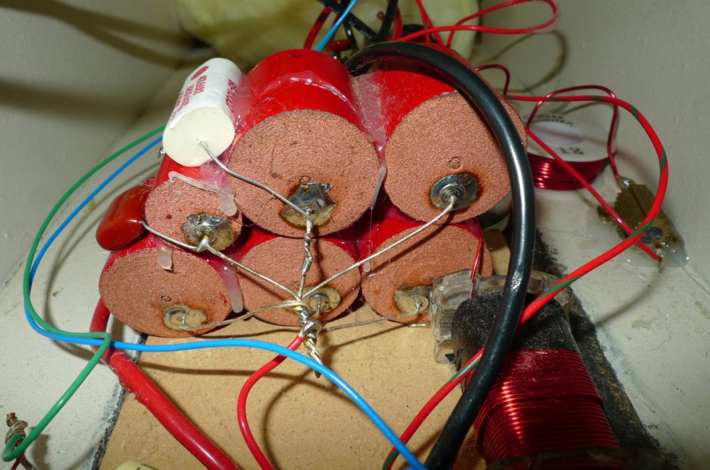

I also have the left RM40 speaker opened up with access to the crossover.  What things should I check with the multimeter?  Please describe exactly how to do it step by step if possible.
I created a video overview of the crossover in the left RM40  with the hope that someone with better training and experience with Brian's crossovers could take a look and help identify any issues with the components.  I also have photos but don't know if they are as helpful as the video will be.

Viewing the opened up the left RM40 and haven't found anything wrong visually.  The caps and the lpads all look fine with no visible defects or no evidence or failure or arcing.  One of the caps nearest the left side passive radiator cut out appears to have hot melt glue on it and has paper stuck to the glue but it does not appear to be exploded.  I will now look over the right RM40 but don't expect to find anything.

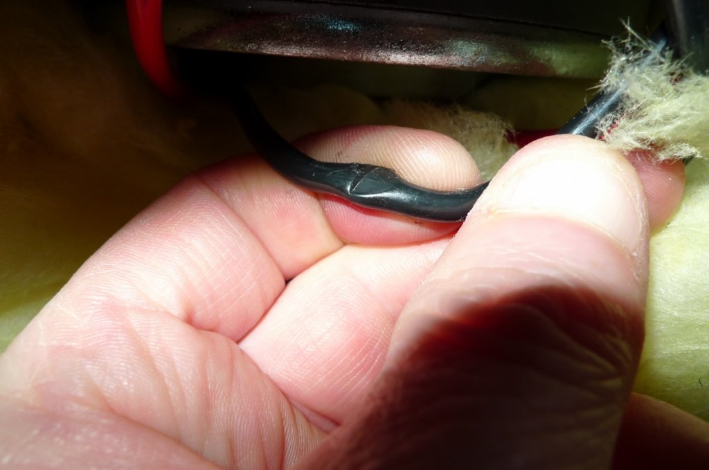

I thought I found a smoking gun when I saw that one of the black wires going to the lower woofer was severely pinched between the passive radiator metal basket and the lower woofer magnet but I did not notice any wires coming thru the wire insulation.  I did not see any melted insulation or evidence of arcing on the basket or magnet.
Photo below of pinched wire but it does not appear to have any wiring exposed or arcing so I do not think this is a problem.
Crossover Pics:
I have other photos if needed.

Re: Torching FST ribbons on RM40's
« Reply #14 on: 24 Oct 2017, 11:17 pm »
Hello Scott, there is a good chance that you burned up the 1.2uF capacitor (Auricap) in the tweeter crossover. The brown capacitor is most likely fine. You might want to unsolder them from the speaker post, to check them, to know for sure. Zak
Which devices are you speaking about from this photo below?
What about all the other large Red 10 microfarad caps and other brown caps in this photo below?

Hal and Zakski....you must mean the "audience" device correct?
So basically I would need to completely unsolder the 1.2 uF "audience" cap from each speaker and then use the Fluke to test it using the capacitance function?
Do I just unsolder one end or BOTH ends?

« Reply #19 on: 25 Oct 2017, 12:46 am »
Scott,
There are two capacitors in the picture with the circle.  One is under the glue that looks like paper on the red cap.  Those two are in parallel, so the total value is the sum of the two values if you can read them.
The other device is an inductor that is basically a coil of wire on a ferrite core.  It will read a very low resistance.
You would need to trace wiring from there to the ribbon tweeter and isolate components by desoldering them to test.  Not an easy task.
