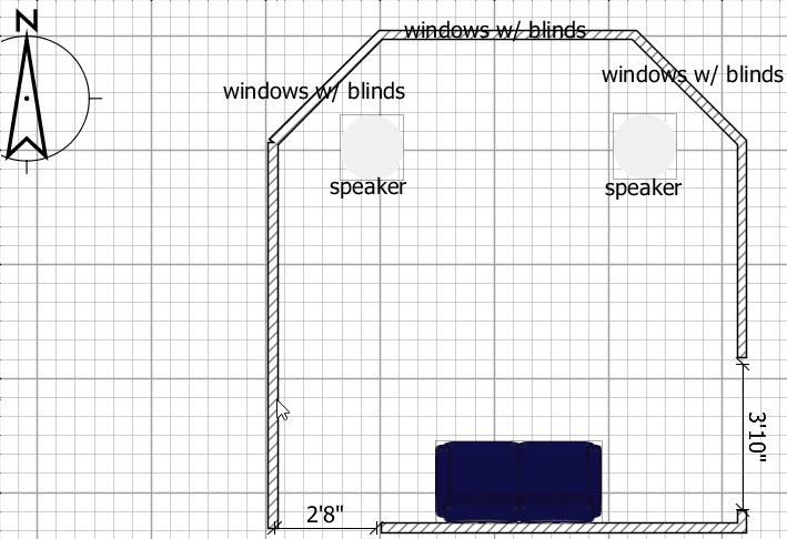

I moved into a new dedicated listening room. It's small. I posted a little diagram in another thread. 13x12x8. Hard. As. A. Rock. Stone tile floors. Bare walls. Not a stick of furniture. Speakers 7ft apart. Listening position 9.5ft away.

Okay, so a diagram of my room...
So, originally when I posted this image I was kind of grousing about there not being too good of a solution for windows, but I hadn't moved into the room yet.
Now, I would do almost anything for it just to be room problems, fix the problem, and start enjoying music again. Haha! But seriously, the music starts playing and I literally feel anxious.
Okay, is this a room treatment thing?

P. S. The diagram is a little misleading in that I used the Sumiko/Master Set method to setup the speakers. I have no boo my bass. It sounds amazing. The speakers are something like 29" from the side walls, 19" from the front walls (that's just where the bass became unmuddied),  and the speakers are out in the room. I'm at a loss if room treatment can't do anything. It images great. The sound stage is cool, and man, that center image is perfectly focused.

Yes, it is a room treatment thing, in the sense that you have a (mostly) untreated room, there is no such thing as a perfect room, and every room can be improved.  :thumb:
There are several ways to go about evaluating and treating this space. First off, if you wish to use GIK products, feel free to contact me and I can work with you one on one to maximize results within your budget.
That said, let's take a look at some of the issues there. First off is placement, and there are a number of setup strategies you can use. Here is ours, with a bit more detail on speaker placement here. The best way to go is to try a few setups and do some testing, either informal listening tests or actual room measurement with something like REW. This will also give you a clear "before" picture of your room, to show us where we need to make improvements.
There are 2 basic strategies I'd start with. First is bass trapping, which will be very important in a small, square room. This will level out the frequency response from 20-20k, and also reduce ringing or resonances common in small rooms like this.
Second is absorbing early reflections on the side walls, ceiling, and also probably the rear wall behind your head on the couch. This will help with the stereo image and soundstage, improve intelligibility, and reduce listener fatigue.
It's no surprise you are having an emotional/anxious response.... that's what music is for at the end of the day, yeah? But in a room like this, it's confusing to listen in because all the reflections are very early in time (because sound doesn't have very far to travel). So our ears are hearing basically the same sound from many locations, ie, first direct from the speakers, then all the reflections coming from various surfaces. It's a psychoacoustic jumbled mess, and our brains don't like it.
But don't worry.... we can certainly make things better using the above general strategies. And as I said I can work with you to determine the best treatments for your room and your budget if you wish to use GIK products.  :thumb:
