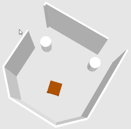

Here is a little quick view of the room. Obviously acoustic room treatment is in the cards. Any thoughts?

Evolvist, I send you most of this as an email.  :thumb:   But I do have some thoughts on this:
Excellent. Yes I can definitely see a concave, high-backed chair causing weirdness. And, the open doorways in the corners are almost like bass traps, because the bass goes out the corners and doesn't come back. So.... well done!  And, there are arguments for never being in the middle of any of the 3 dimensions of the room, including left/right, because you will be sitting in a modal null point for the frequencies related to the width (quarter wavelength, half wavelength, etc).
The cost of a non-symmetrical setup, however, is the suboptimal imaging/soundstage. The way to regain this is to get the reflection point absorbers up on the side walls and ceiling. By eliminating these early reflections, it will re-assert some acoustic symmetry, and the imaging/soundstage will improve.
I would also treat the walls behind you, especially if they are aiming reflections back to your ears. From the drawing, it looks likely, though you can also check them with the "mirror trick." For these panels on the 3 angled rear walls, I'd consider using Scatter Plates inside the panels, or if you prefer the look Alpha or Impression series with the plates outside the cloth.
I'd still recommend making all the panels as thick as possible, so it helps level out the differences between low & high end in the room.
Once you have maximized the sound potential of the room with the best possible setup, you can really take things next-level with treatments.
