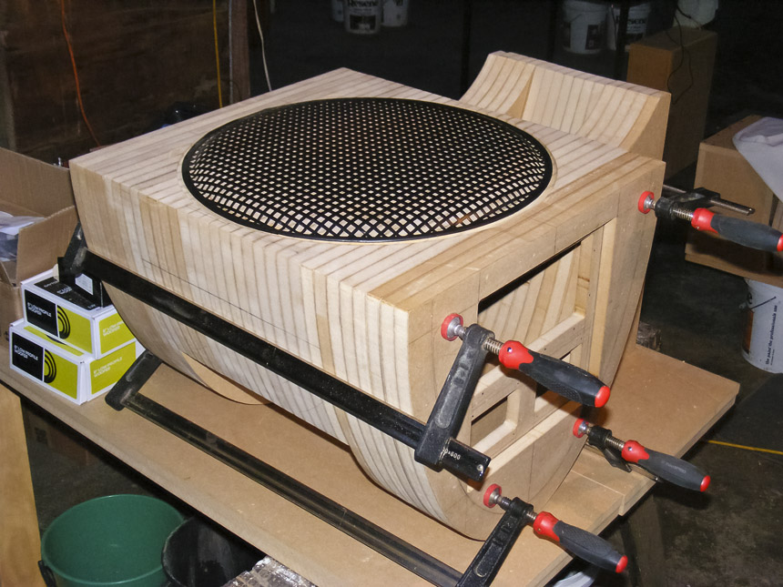

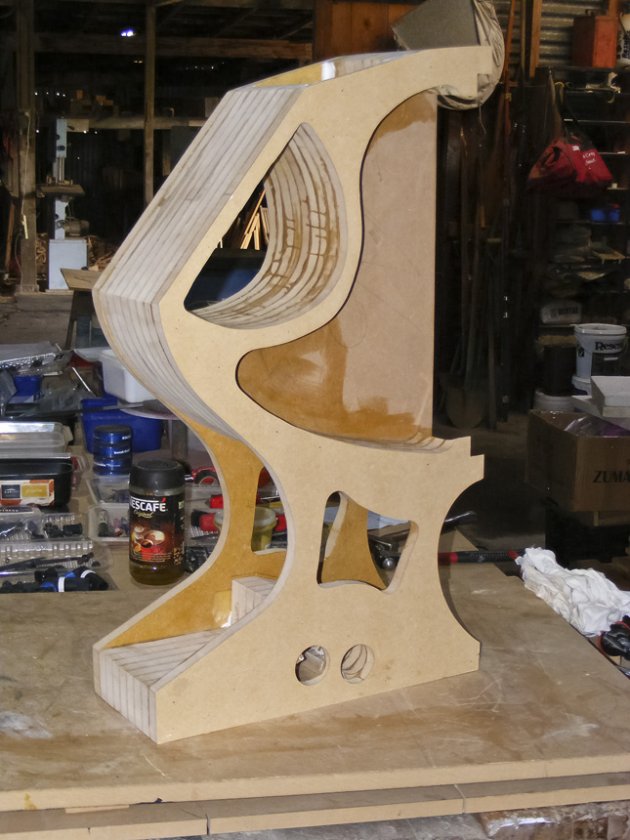

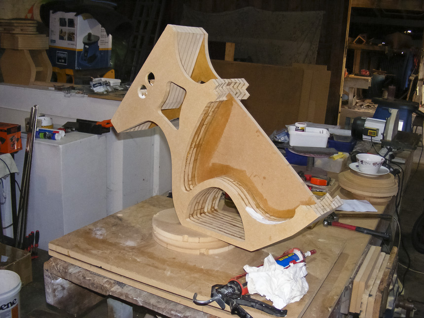

OK, this will be a cabinet build as a ‘Triple Chamber’ compact single unit!
A Triple chamber simple because as it will be housing three (3) 8” speaker chassis each in its own dedicated compartments with volumes between 16 to 25 liter. The chassis are a Peerless woofer 8” with a 10" Passive Radiator, a Source Point 8” in a sealed compartment and a GTS Full range as well in a sealed compartment and a 2.1 plate amp plus a few other items to make it all work.
rgs UpperCut

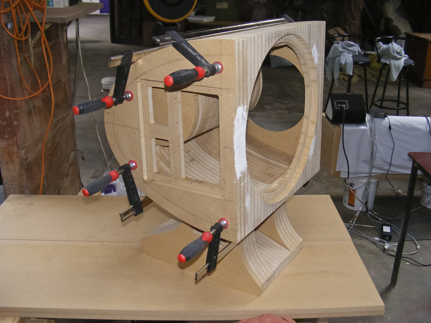

UpperCut
  • Posts: 114
    • UpperCut - Audio
Starting to glue from the center! as now to be seen there is a center slice to part the large volume into two for the woofer & the Point Source. Very well to see the top small compartement for the carry handle as well as at the bottom.
rgs UpperCut

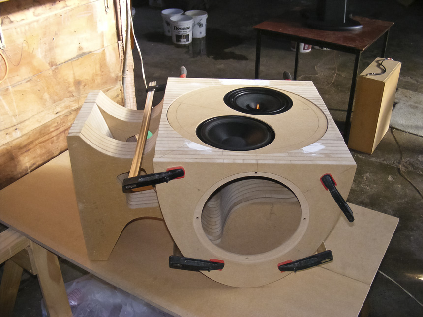

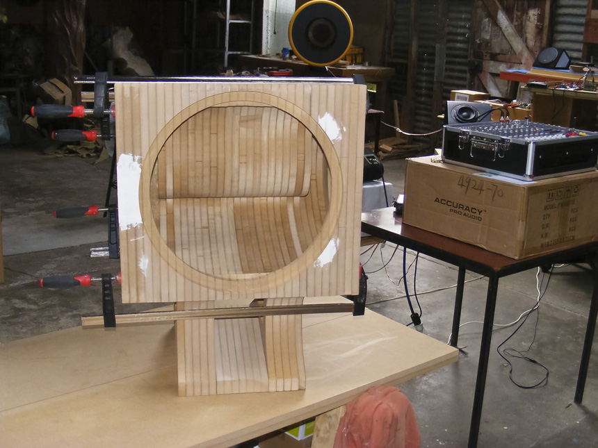

UpperCut
  • Posts: 114
    • UpperCut - Audio
And once again a few steps further! This unit is quiet a lot of work thats for sure.
rgs UpperCut

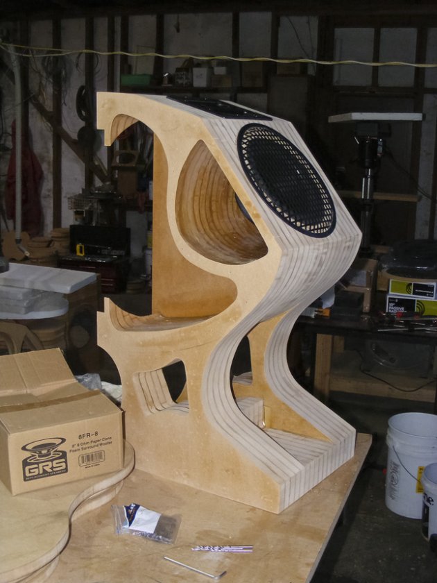

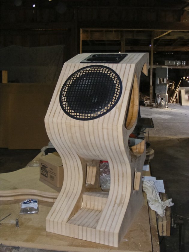

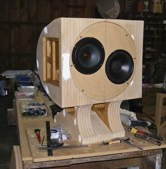

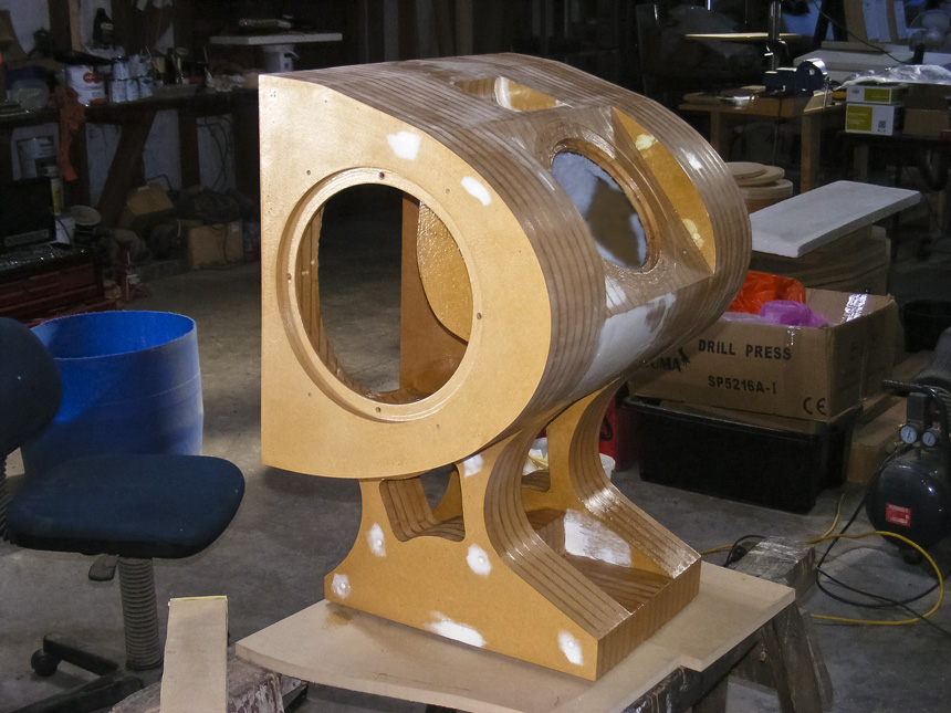

Hi there again,
After an extremely wet & cold few days (at least cold by NZ standards) I’m back in the workshop finishing off gluing both sides of the unit & letting that glue cure for several days. Afterwards I did finish shaping the whole enclosure and dit some more detailed work like placing the holes for the baffle etc.
One Image is showing the first fitting of the two front chassis & the second shows the enclosure after the very first sealant is painted onto the outside (as the inside sealant 3 coats is already completed).
rgs UpperCut

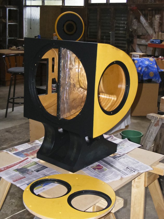

UpperCut
  • Posts: 114
    • UpperCut - Audio

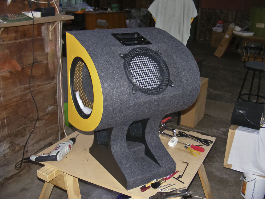

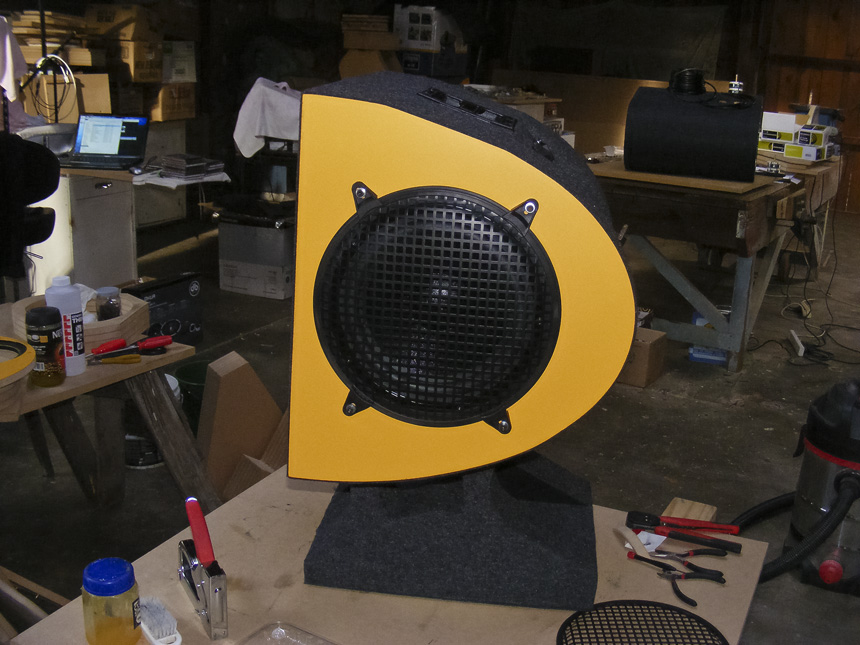

First (charcoal & melon yellow) base coats on enclosure, and the first layer of dampening on center dividing panel.
rgs UpperCut

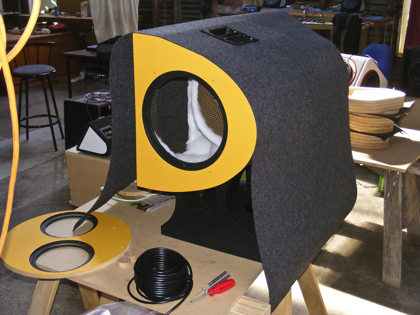

UpperCut
  • Posts: 114
    • UpperCut - Audio

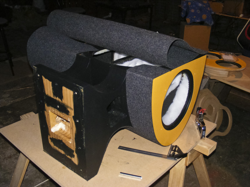

The whole enclosure is getting covered with a ‘ONE PIECE’ of dark grey Felt (lower front legs, front plate, top, upper rear & lower rear legs etc.
rgs UpperCut

Truly this Felt covering is a great and very Interesting job to keep you on your toes not to make any mistakes!
rgs UpperCut
« Last Edit: 25 Aug 2017, 09:28 am by UpperCut »

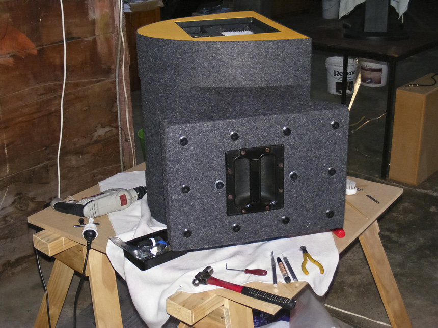

UpperCut

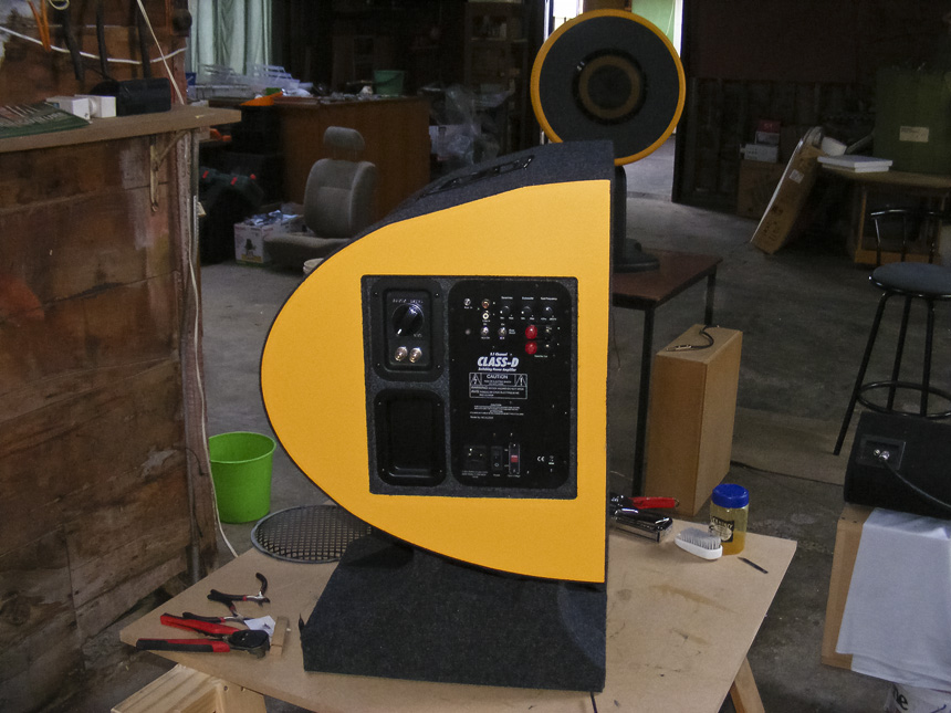

  • Posts: 114
    • UpperCut - Audio
Well, to cut yourself with a scalpel is not really my idea of fun, but I guess if you try to hard to do things perfect that can easily happen and so it did! Very Painful!
The first fitting of the electronics side after covering this section with Felt showing the speaker points and an L-Pad at the left side connected further to the Fold Back chassis as well as the Amplifier & the Passive Radiator side.
rgs UpperCut
