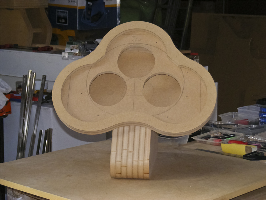

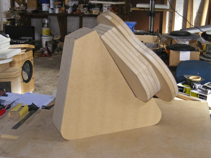

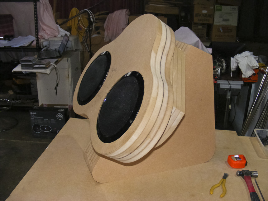

In my projects I always like to have incorporated many different options because I like to test with one and the same unit a few different set us, but while the proportion of it & the calculations are correct I have found that I have a small problem with the deeps of the front component unit to be able to use all my options I wanted to build into!
I was truly trying to keep the weight down on this unit, but I’m simple short on 1” (25mm) deeps, and so I have to use another 18mm slice & a 12mm slice with another volume increase of about 4 liter in total to get that needed deeps measurement and to use not only low profile woofer speaker chassis but also other standard 6.5” & 8” chassis etc.
Anyway, I guess live, learn and adapt to suit the rest!
rgs UpperCut

It maybe came over wrong, but it was measured & calculated only for the 'Low Profile Chassis', and when trying a standard size chassis it was expected to be a little short. Something like that is no problem when you build with slices (with I.S.C.T) - add or removed a slice (different thicknesses) or two = volume, and even then there it is no problem as the compartment volume can be easily changed & fine tuned once you have completed the RAW stage.
This is also a TEST enclosure where many things could be changed while getting it right! In any case if I would not like the whole set up as I see it well scrape it & build a new one.
rgs UpperCut

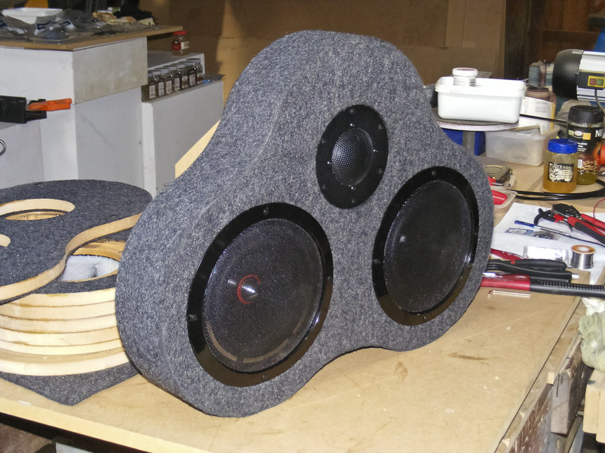

First main module: Chassis fitting after Felt covering!
rgs UpperCut

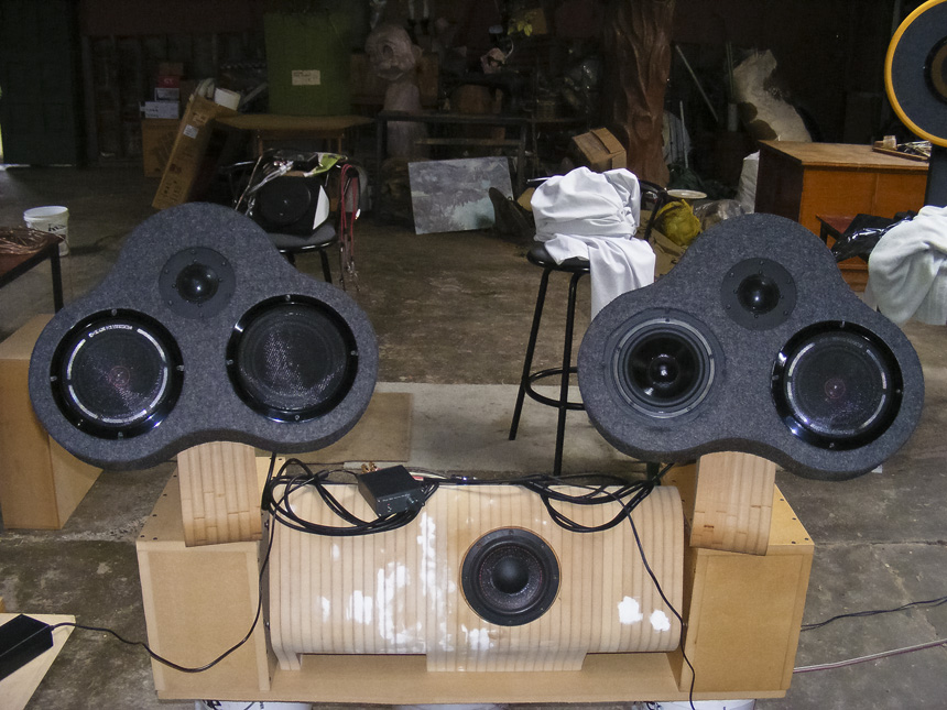

First test run on both Fold Back units with a 120W per channel Bluetooth Amp, and then with a small Amp as well as a Sub with an external Plate amp!
One cover over one of the 6.5” PR’s is still missing only arriving in three or so weeks, but no rush as I have still not completed the base units for these.
