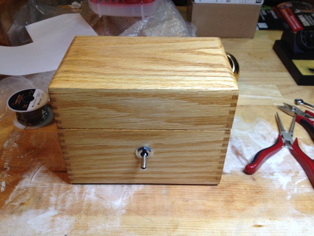

I was faced with the same problem, having two amplifiers and one set of speakers. Both amplifiers are tube amplifiers (Atma-Sphere and Bottlehead) and there has not been any issue for either running without a load.
Here is a thread about a DIY amplifier switch (if DIY is an option):
http://bottlehead.com/smf/index.php?topic=7476.0
Also a few photos of the switch I built using a wooden box:
At the source I just used a splitter for the RCAs. So you don't necessarily need two switches. It works great.
