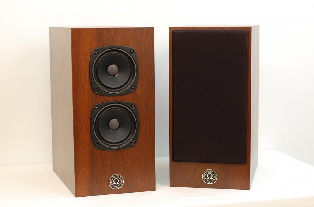

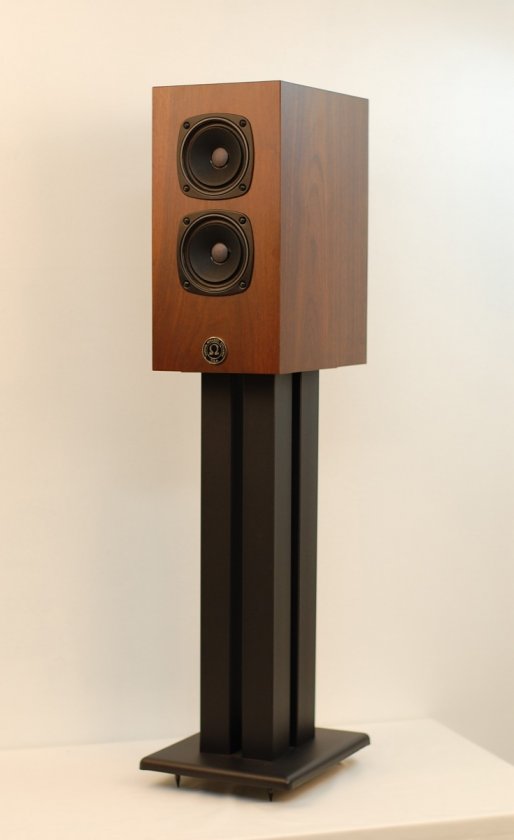

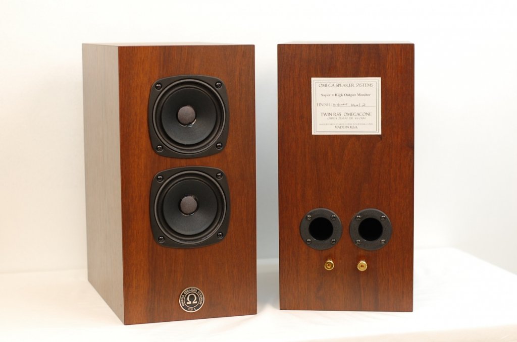

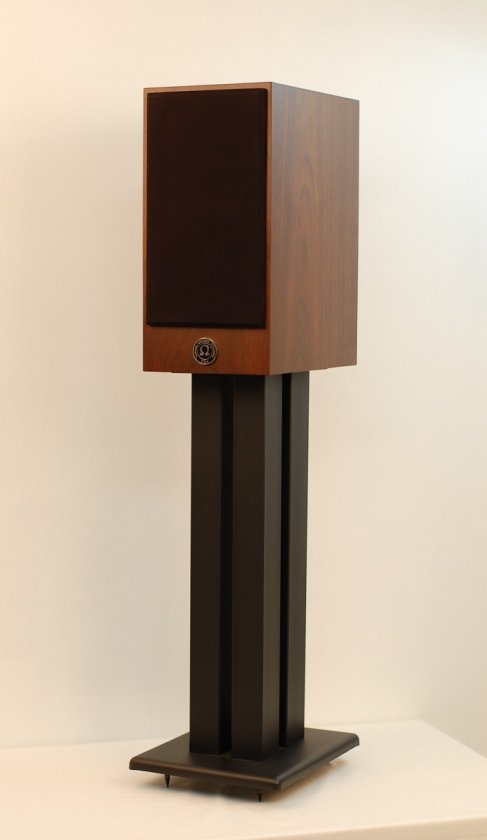

Hi All,
Here they are and one of the best sounding small monitors I've ever made.
Size is 16 tall x 8 wide x 12.5 deep.
Speakers pictured are finished in Walnut and still figuring out the prices.
I'm working on a shorter name too.
Louis
