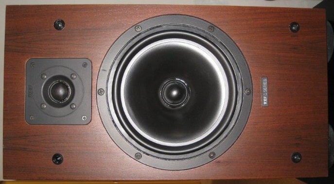

Didn't really know if you were looking for used vintage speakers or not.  I have a pair of what I think was one of the better sealed vintage boxes that was produced - the KEF C60 (1985-1988).
They have an 8" cast frame woofer and T33 dome tweeter / crossover from the KEF Reference Series, and are specced at 89dB, 4 Ohm, F3 of 66Hz and 110dB max output.
They are larger than the NS-10M Studio - 18.5"H x  9.8"W x 12.3"D - and are constructed with 22mm MDF and weigh 26.4lbs.
Because the tweeters were ferrofluid filled, they may require ferrofluid replacement, but I was lucky enough to acquire an absolutely mint pair that doesn't appear to need servicing.
Steve
