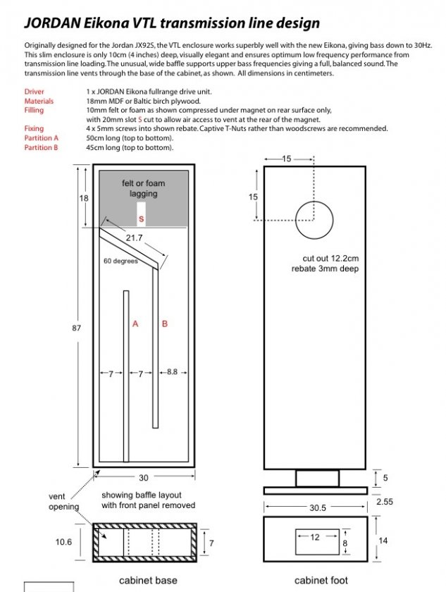

The well known, and perfected pipe design is easy to make in an hour, and promises an F6 of 27Hz.
Can you point me towards this design? I am not sure I am familiar with it. I have been exploring a few designs for this driver and it is an interesting change from the older JX92S which I have used in the past and still own.
Martin
Dmason
  • Posts: 1283
Re: EJJordan Eikona based speakers
« Reply #8 on: 6 Jun 2016, 08:36 pm »
Hi Martin..
Look on the speaker design page www.ejjordan.co.uk
I've twice read that the original "VTL" purports to work "even better," with the Eikona. I am inclined toward the wide baffle. User anecdotes are uniformly impressive.

In my opinion the VTL enclosure was not that great of a design for the JX92S, it was a rule of thumb design to the best of my knowledge. The ML TL designs calculated for the JX92S driver by Mark Dikovics (formally Jordan USA) were really very good.
That being said, the Eikona driver is quite a bit different from the older JX92S and just stuffing it into one of these older enclosure designs in my opinion is not an improvement/upgrade. I have simulated these two designs (VTL and ML TL) with both drivers and the Eikona does not work as well as the older JX92S.
I am sure that the Eikona is a great driver and it really warrants a new enclosure design optimized to bring out the best performance.

I'm with Martin King (MJK) on the VTL design.
My JX92S ML TLs still serve as my daily listening speakers after 10 years of use.  Others followed my successful design via postings on DIYAudio.  The Eikona ML TL design promises to have the same listening satisfaction.
Jim Griffin

And far easier to build.... The 40" seems an easy bullseye winner.  Thanks for your efforts Jim.
