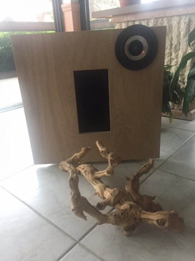

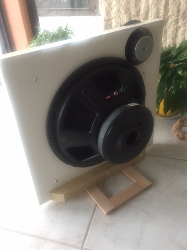

I'm going to do a write up on 'The DJinns" over the holiday break, and post in the Open Baffle circle. I am VERY impressed by the Eikonas in this design.
