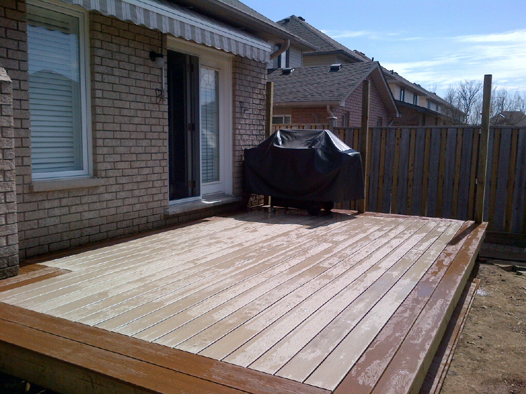

I used to have a cedar deck and attempted to use Restore (one of the roll on deck paint/thick covering options).  I found that did not help that much, but my cedar may have been too far gone.
We had Trex installed about 2 years ago.  We used a light color for the majority of the deck (no heat underfoot at all), and did a border with darker (yes, that does get warm in direct sun).
I had a bit of mold this Spring, but Simple Green, a brush and a hose - 30 minutes later it is perfect again.
I do find it slippery in the winter, but hey snow and ice will do that to most decking surfaces.
Love ipe - I built a step out of it for my shed - super tough, never need to stain etc.
I would bet that ipe will be more than Trex.
Here is a thread that outlined the whole project back in the summer of 2014.
http://www.audiocircle.com/index.php?topic=125259.40
Here is a pic of top of the deck done, but some of the other work still underway.  The link shows the final products later on.
