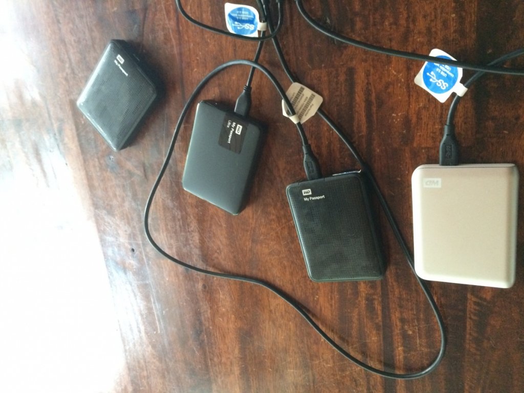

We owned 4 WD Passport drives, all 4 died within 2 years... 3 of them were plugged in and never touched again, so "rough handling" definitely was not the problem for those 3.
Be safe and buy a NAS with at least 2 drives designed for a NAS. Yes, the good ones are expensive, but like with audio gear: for quality you pay.

I have never experienced a failure on my Passports, and started using them because James Tanner recommended these drives.
One of my smaller WD My Passports does make the squeaking noise, apparently indicating little power to spin them up. Had to put it upright. I've replaced it with the 3Tb Ultra now.
The reason i like multiple drives is risk management. If one failed, not all files are lost, and backup is easier.
I had a Lacie 500gb drive once in a nice aluminum casing, looking great, but it was expensive, power-hungry, noisy, and rather unreliable.
Since using the WD's i really never had reason to change, especially since i have my drives stashed away out of sight and out of hearing.
Thanks anyway, appreciated!
