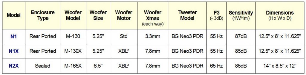

Whats the difference between N-series  N1,N1X and N2X.
Also is this one series higher than the X-series ie X-LS encore

The X-LS series speakers used a soft dome tweeter.  The N series used GR-Research version BG NEO3PDR planar tweeter.

GR Research N Series Comparison:
Danny Richie
Re: GR Research Kit query N series
« Reply #3 on: 4 Apr 2016, 02:14 pm »
That pretty much sums it up.
And that Neo tweeter was a favorite of mine.
Of all of the best dome tweeters that I have used the T26SG used in the Encore Series was a favorite as well.
