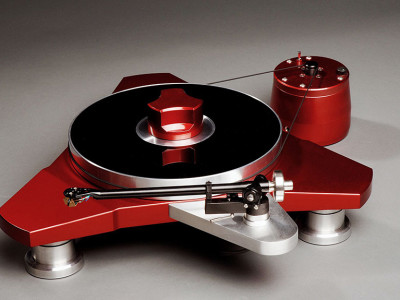

Swapped a pair of home built amps to a buddy for a Jolida phono pre  and a Vyger Timor turntable.  The Vyger is eye candy, but there are a couple of issues.  It is built for a Rega 300 arm, and I've got a Jelco 250 I'm trying to make work.  The Jelco calls for 214mm pivot to spindle, but the best I can do is 225mm.  Can this be made to work?
sunnydaze
Re: Trying to mount a tone arm that doesn't really fit
« Reply #1 on: 30 Mar 2016, 01:21 am »
Outboard arm pod.  214 is fairly close,  so it will need to go close to the platter.   In your pic there are two possible locations,  where the red plinth edge is right underneath the platter.
Or check with mfr.   Is the silver mount board removable?   If so get one cut specifically for your Jelco.
It will NEVER work on your current setup.   Not only is mount distance wrong,  but mount pattern is completely different : single hole for Rega,  Linn mount system w 3 bolts for Jelco.
Hope you get it figured out,  I think the Jelco will be a nice upgrade.   I have the 750E ten inch version and it handily beat the Michell TechnoArm (a souped up Rega)  I tried.   Mounted a Dyna 20x on both.

Thanks, that's what I suspected.  Yes, that extension comes off, so I'll make one out of wood to fit the Jelco. :thumb:
As for the mounting difference, I was looking for something quick and dirty that wouldn't screw up the finish on the Vyger... so decided to hot glue it for easy removal.  Damned if it didn't work, and was surprisingly firmly stuck.  That's something I'll stick in the back of my mind for another day.

I suggest checking your local bed bath and beyond for bamboo cutting boards.   They are dirt cheap and come in various thicknesses.   I have used them to make several armboards and outboard pods for mounting xtra arms.  (pics in my gallery, if interested).  And I use a thicker 1.5 inch thick one under my Eurolab table.   Sounds great in all cases.
I believe thicknesses available from about 5mm to 20mm.  Obviously it's important to be mindful of this for correct clearances,  and arm height relative to platter.

The SP10 is a MKII.  I have a  Jasmine on the way from Hong Kong, arriving later this week-Vyger wanted an arm and a leg for one.  In the meantime, I've made a mount for the Jelco out of nice piece of mesquite burl that I had out in the garage, so I've got it installed.  The shaft on the original motor was bent.  A local electric motor guy showed me how to true it up- I kid you not- with a Sharpie and a small hammer.  Took me about 30 minutes of marking, tapping, marking, tapping, but damned if I didn't get it pretty straight.  Interestingly, he said that once bent, they usually won't hold true after straightening.
Scott,
Mesquite is, as I recall, notorious for moving a lot with moisture.  You might want to keep an eye on your arm board by checking alignment periodically until you make it through a couple seasons.  If it's quarter sawn (unlikely for a burl), it would be the most stable. Sure can be pretty, though!

How about finding a discarded piece of Corian from a kitchen countertop contractor? Less resonant than any kind of wood and you may find a piece that will look cool against that red plinth.

Once I get the motor issue solved, I'll re-address the arm mount.  Corian would be a good option.  Does anyone here know how to cut, drill, and shape it?
Corian works easily with wood bits--like butter.  Stable, too, so would be a good choice.
