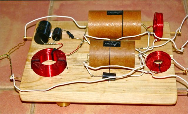

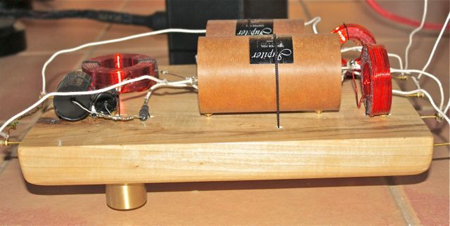

I own the pair that was  first shown at RMAF. They have the old style wave guides. I’ve upgraded all the caps ( except the notch filters which is the next upgrade I plan ) to Juniper Copper Foil and mounted them on 2"maple slaps with Mapleshade brass footersand rewired the x-over and speakers with Jupiter cotton covered copper, which has made a very nice inprovment.
 My room is 22’x30’ with one end being half an octagon ( in my gallery is a diagram of the room, it’s in the acoustic circle album ) the speaker are located 15’ from back wall, 6’ from side wall, 8.5’ apart and 12’-13 from LP. Right now I have with a 9 degree toe in, but I’m still playing with it. The sub is centered between speakers. The room has Jeff Hedback designed acoustical treatment along with some diy treatments.
I have a modified Mac Mini, exasound e20 dac, Modded Ncore400 dual mono amp, cables are Mapleshade and TWL PC on the subs. All source equipment runs off battery and the amps are on 2 dedicated circuits that come straight off the output of my inverter using #8 cryoed wire.
I’m working on a balanced tube buffer based on a Gary Dodd design that I hope to have finished and burned in by end of the month.
Welcome, Mike.  Your crossovers look very well isolated and stable.  Beyond this...
...I haven't had the ambition to move beyond adding Dynamat Ext. to the 4 granite plates.  But there's a lot done so far.  The tweeter hi-pass cap is ALL SoniCap Platinums*; the MR-shunt cap is now 13uF of SoniCap-Is** plus 2uF of Platinums, soon to be replaced with 10.5uF of SoniCap-Is and 4.5uF of Platinums, and the MR-comp. network cap is 56uF of SoniCap-Is plus a 0.33uF Platinum, with the latter soon to be replaced by a 0.47uF Platinum (just because I have them and need to use them in something before I get smarter than I am right now and QUIT this foolishness.)  :roll:  The tweeter-shunt coil is now a Goertz/Bridgeport copper-foil, and I have same-type coils to replace the other two.  I also have Neotec UPOCC-in-Teflon solid wire, copper and silver, to replace all wiring.
* The Platinums are made of Teflon-alloy film and tinfoil
** SoniCap Gen. Is are metalized polypropylene

A bigger difference will be to change the 16 gauge Erse coils to copper foil wax Jantzens......way, way better.  Use the 12 gauge ones for the mid range and 16 gauge ones for the tweeter.  Go into the inside of the coil and out the outside....much better sound this way.  I know Danny does not like the Janztens but I have A/Bed the Erse coils versus the Jantzen wax foils and the wax foils are in another whole league.  Way more information, low level detail, faster, more dynamic.....just plain more real.  This was used and tested on my own speaker that uses a single Neo 10 and a single Neo 3 on an open baffle (fantastic sound, by the way).  I am using a Sonic cap with WA Quantum chip on it for the tweeter series cap.....bypassed by Jupiter copper foil .1 and my modified Wima .15 cap.  The cap on the midrange circuit is a Rike cap bypassed by a Jupiter copper foil.  Wire is Neotech 14 and 20 gauge litz braid wire.  Ground Enhancer hardwired in as well.  Everything hardwired.....right into the amplifier.
