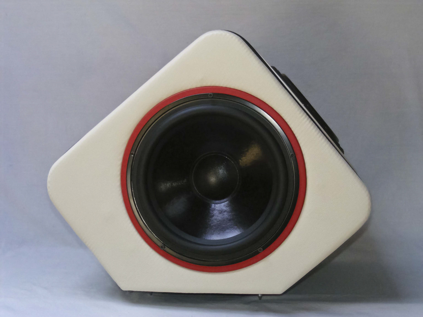

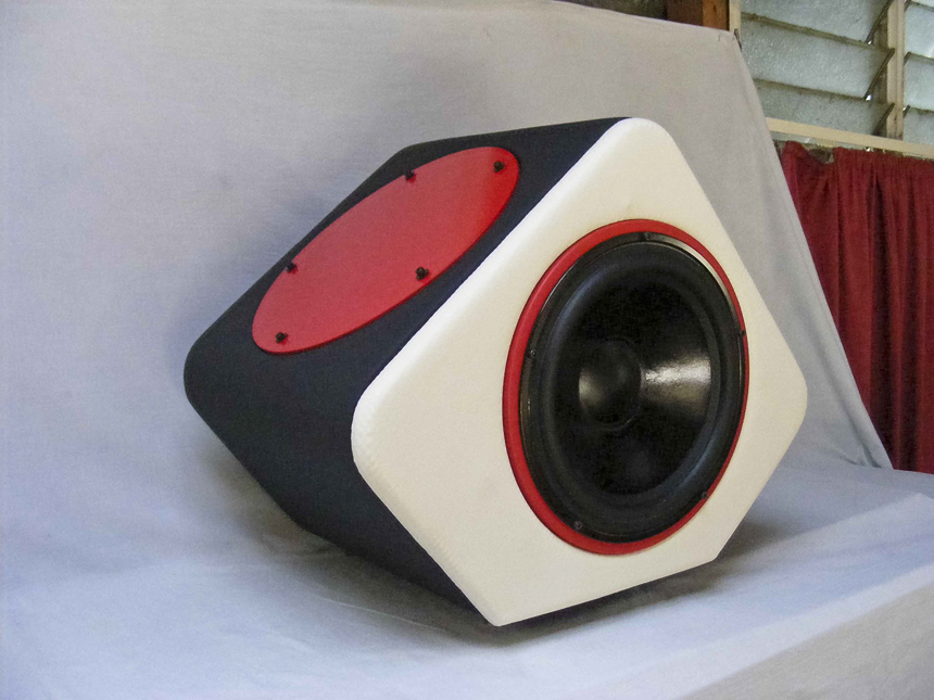

Let’s start with no. 3:

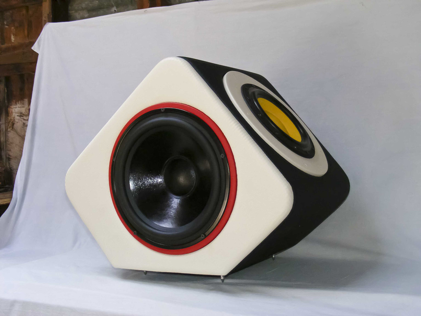

Next up no. 2:

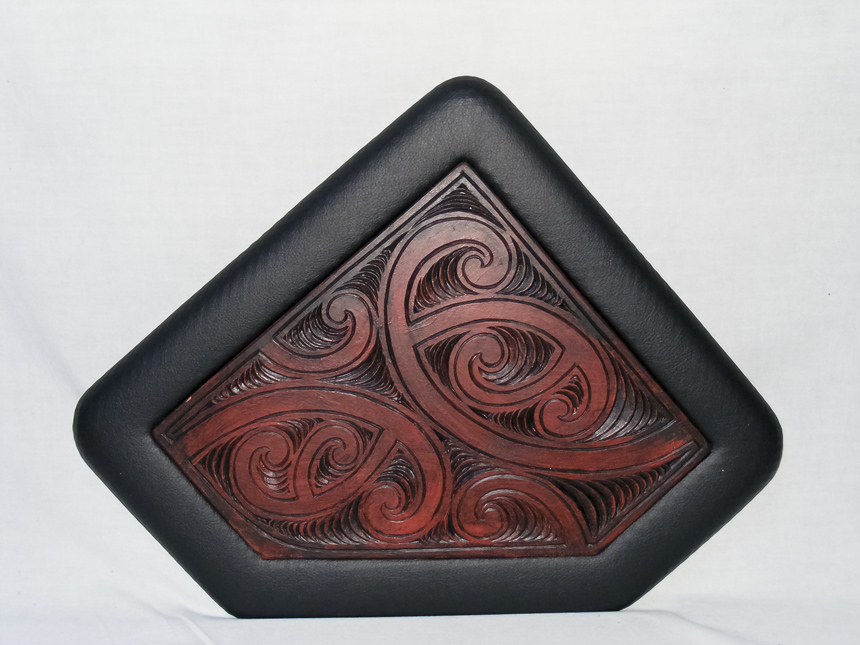

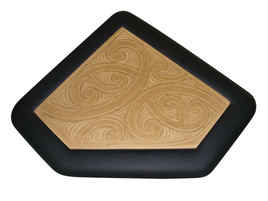

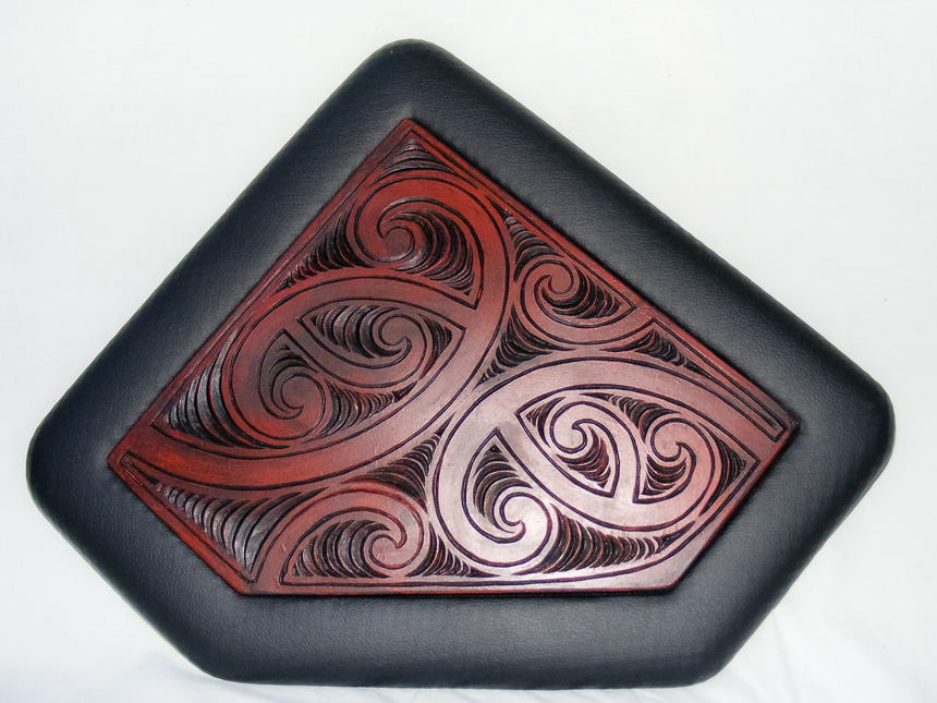

Exchangeable, Artistically Enhanced site Panels as in Solid wood, MDF wood Carving or Leather Carving Etc:

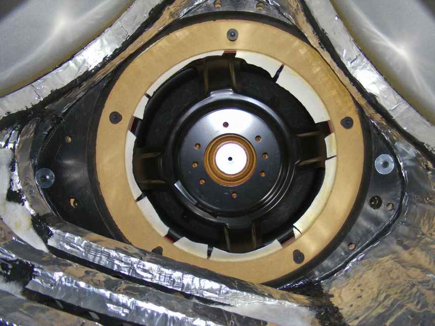

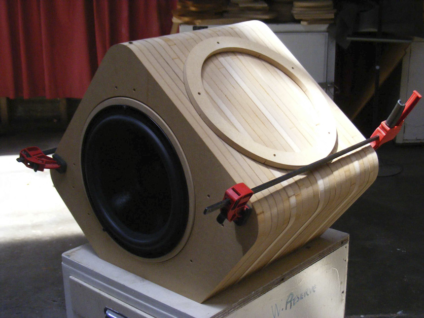

Now the no. 1 size: This is an Image in the very early stages of the build and it is suited for 8", 10" or 12" speaker chassis and single or dual Passive Radiator use up to 12". This is a build up and in the Image you can see one side PR & a rear PR with speker chassis on the oposite site as in no. 2. I'm actually much further then this Image - close to it getting covered and finishd off! yet I have a problem at the moment with my PhotoShop so newer Images have to wait until I fix that one.

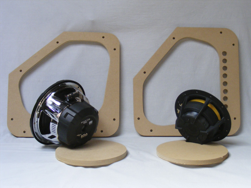

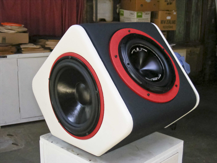

Let’s start with no. 1:
I mentioned that the volume of the enclosure would lie between 30 & 60 Liter, but this one as on the Image is AS IS between 33.5 & 36.0 liter presently. I'm not sure as yet which of my two (8" Swan / Hi-Vi 8 Ohm from Canada or the 10" Boss 4 Ohm automotive driver) as these are drivers I have at the moment in that size so I assume it will be the 10" first as I'm still looking for a suitable 12" at the moment for running & testing.

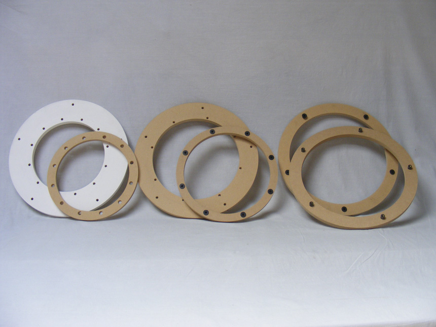

The next Image shows outer and inner decoupling rings A) left side white outer speaker decoupling ring & an inner ring both for the 8". Middle one is a 10" outer ring again & an inner one this time with threaded rubber nuts. The third set are both inner decoupling mounting rings for two 12" PR's.
This Image now is showing the two drivers I will use, and as well as two more options of using the exect same enclosure as above in a different way!
Well, that is it for today but more will come ASAP - some of the main items are getting covered at the moment!

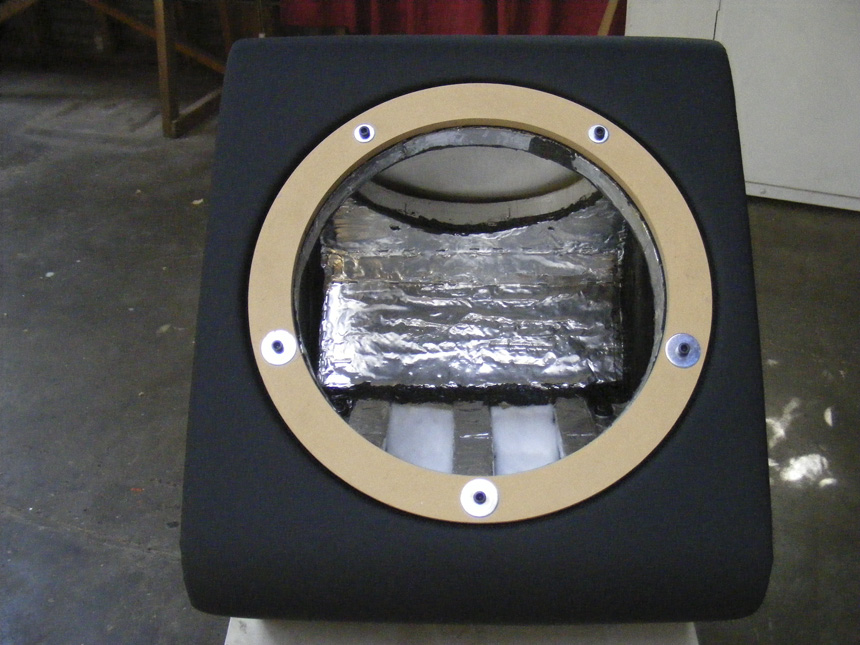

As per the above write up here a few new Images to be shown what happen on the weekend.
The body part has been covered with charcoal artificial leather! The decoupling ring is only used presently to mould into the cutout.
Side view 1: The colour scheme is related to our New Zealand indigenes people which use Black, Red & White in there Art! I have used charcoal instead of solid black as the main colour as black comes with the PR’s & most speaker chassis. All colours are artificial leather.
Nothing as yet is trimmed still all quiet raw, but a view of some of the structual.

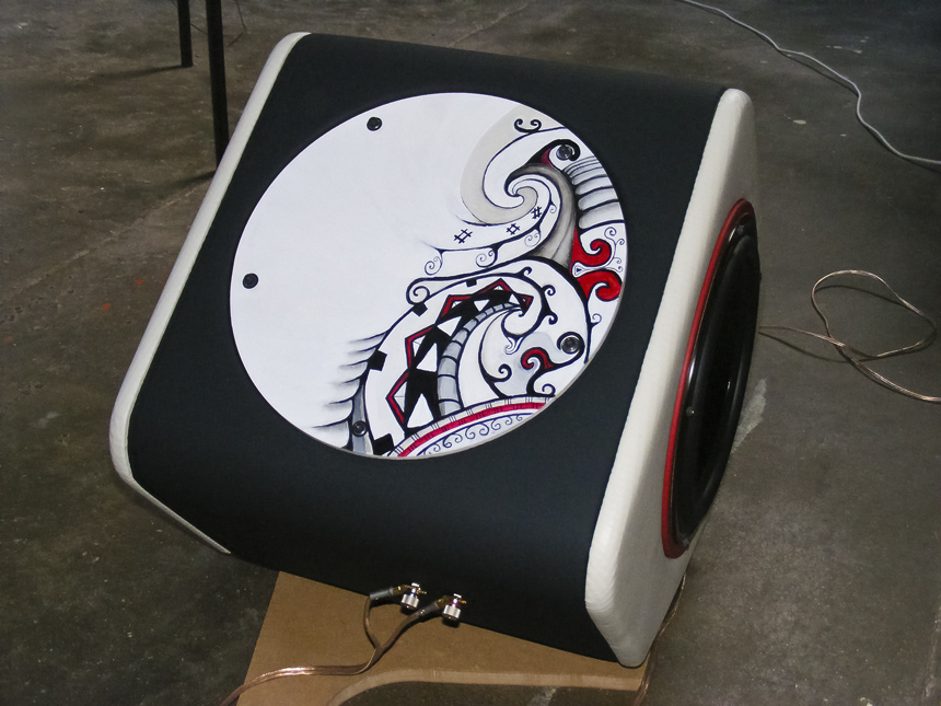

Hi there again,

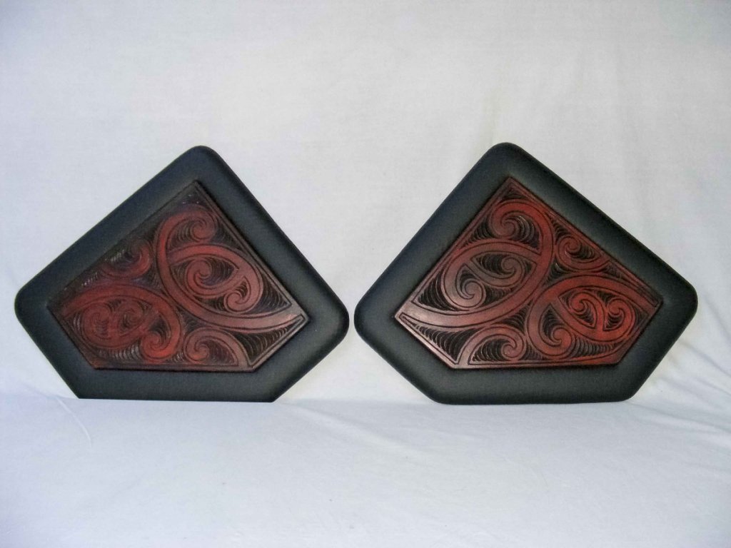

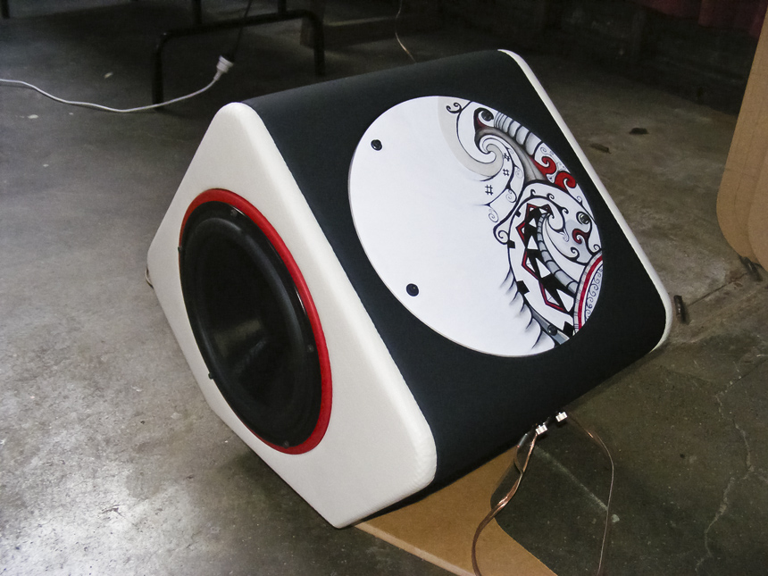

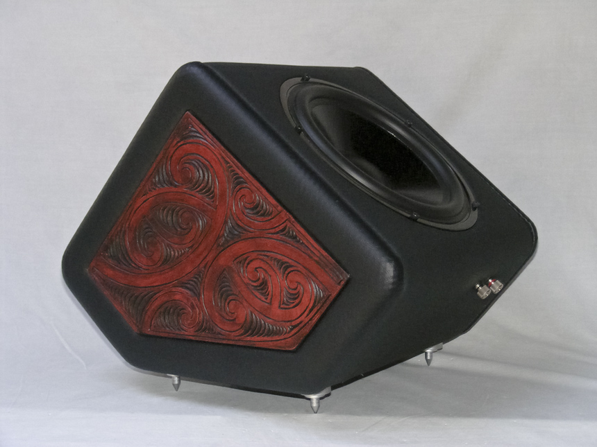

Just picked up the 'Artistically Enhanced' painted panels from the Artist. New Zealand Maori Art & Colours as a lay in for the side panels intended for no.2 enclosure!
UpperCut
  • Posts: 114
    • UpperCut - Audio
UpperCut
  • Posts: 114
    • UpperCut - Audio
Hi there,

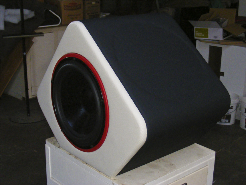

Finally after month the Art work for this sub came back & with that it is ready to get run in!
rgs UpperCut
