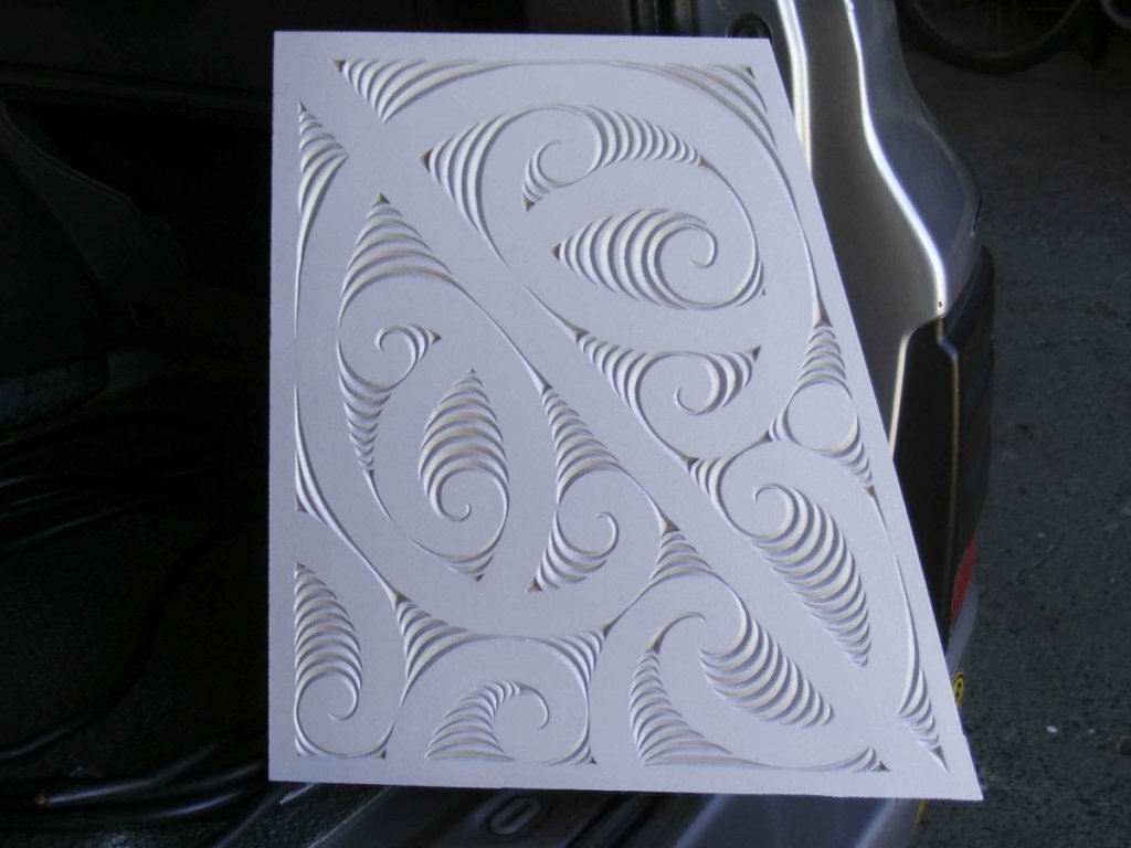

Rough cut side test panel with New Zealand Maori Ornamental Carving:

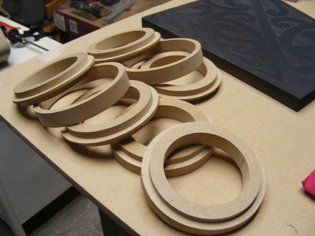

Sandwich method for a body housing a 350 RMS Super Bullet Tweeter (these are so precise made that they are only need to be press-fitted.

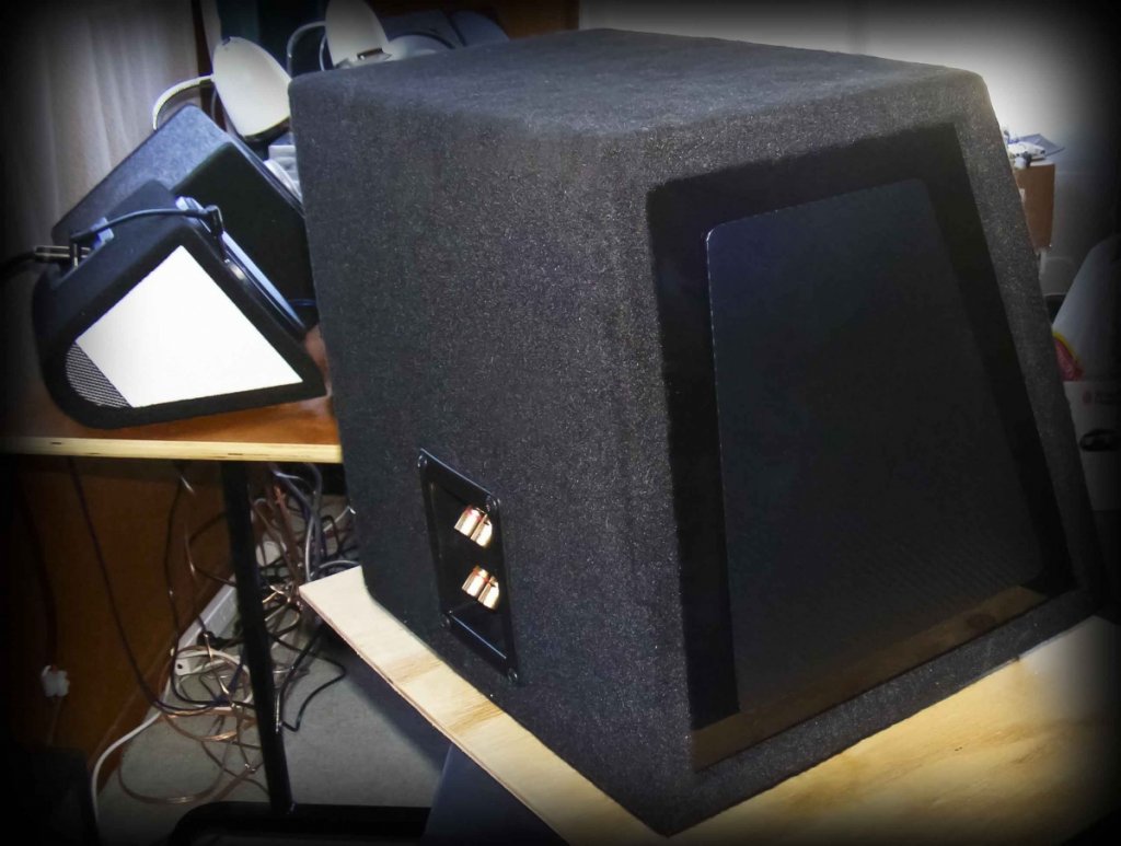

This Image shows a automotive Sub with dual floating Dispersion Panels each side, and the smaller white one in the background is a single panel arrangement
