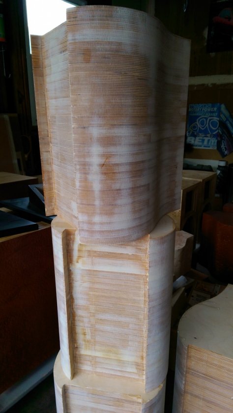

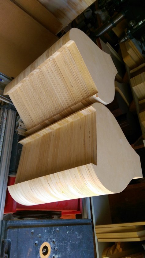

I talk with people all the time that just don't get it.  They don't understand all the fancy words on our website, and how that translates into a better enclosure.  I'm not implying they're dumb, just that what is obvious to me isn't necessarily so to someone else.  So I wanted to share a sequence of pictures to demonstrate a bit just what all goes into the making of a Cirrus cabinet.

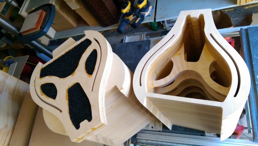

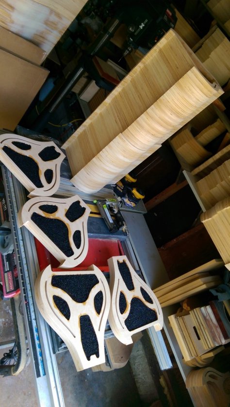

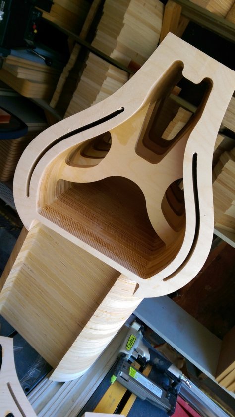

After cutting on the CNC machine of all the cross-section slices, we stack them.  Each top/bottom end cap is filled with about 5 pounds of our Inversaion Layer material mixed with epoxy.  Once the epoxy sets we attach them to the cabinets, but not before also filling the void in the walls with Inversion Layer material as well.  Also before attaching the end caps, the entire inside of the cabinet is thoroughly sealed to prevent any movement of the wood.

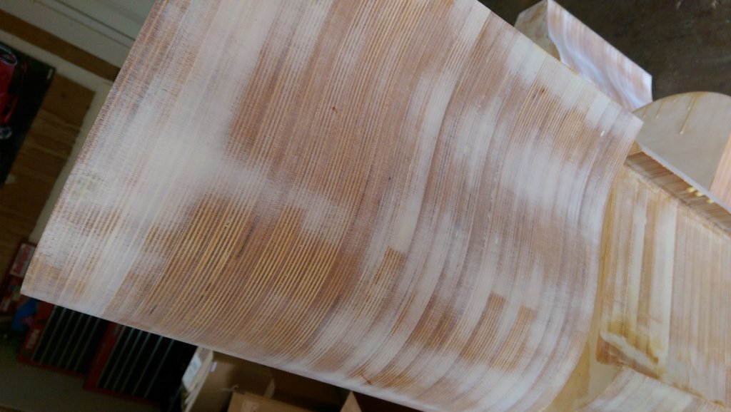

Once assembled, we do a rough sanding using a long bar sander to keep the surface flat, and then apply a THICK layer of a material that I'll never ever tell what it is.  People have been fighting with the problems stacked ply cabinets cause for a long time, now that we've figured it out we're not giving away our secrets  8)
After this material is cured, we have to sand again with the long bar sander.  Stacked ply cabinets will be uneven no matter how clean your cuts from the CNC are.  This material, and sanding in this way, evens out the high and low points to create a smooth surface for veneer.
I hear all the time, "why don't you make your cabinets simpler".  That holds no interest for us, plenty of people out there are making square MDF boxes.  If what we're doing isn't clearly unique, and clearly better, than I don't even want to bother.  And I think we certainly have accomplished that.

Do you still offer the natural look like the pic on your website? The "secret" layer you apply to the sides seems to darken the ply. Does this lighten in color once dry or do you prefer to veneer over this anyway?
Looks impressive, love to see what the new Cirrus will look like with the new drivers.

WAHOOOO!!!! Thanks for the post Ryan, this is really cool.
Just curious, are the CNC cuts in the caps and top/bottom of the cabinets for some kind of biscuit joint?

Yes, we offer the bare ply look instead of veneer as well.  In that case we just don't apply the secret sauce, instead a whole lot more sanding has to be done to get the surface dead flat on it's own.  I'm surprised that bare ply hasn't been more popular over the years.

Those slots in the walls are where the inversion layer material is filled.
Got it, like a warm blanket inside the cabinet wall. That's a really interesting construction technique. From Ryan's original description, I thought you were filling the larger voids in the cabinet. Thanks for the clarification!
