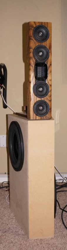

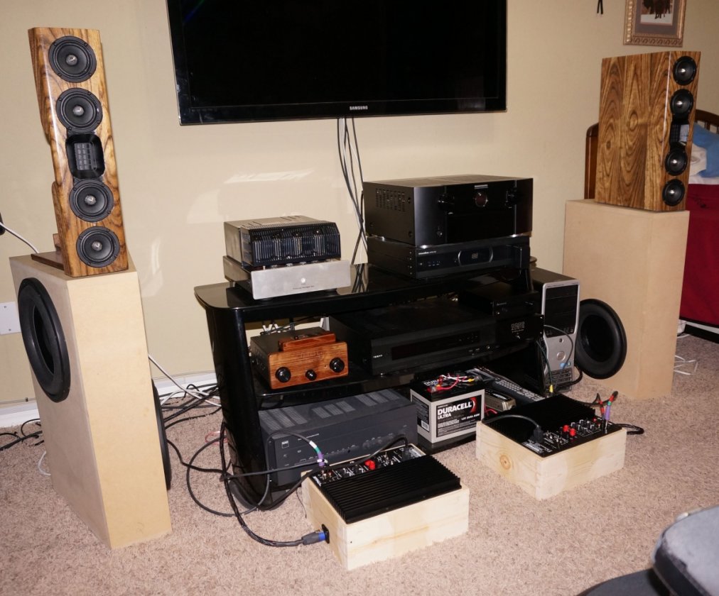

I'm using a pair of Rythmik F12SE with my Spatial M4 Turbo. I'm also using a Line Magnetic LM-518IA. This setup is strictly for 2 channel music only. I'm still working on fine tuning everything, but so far the setup is fabulous. The bass is tight, fast, and deep when called upon. I can't speak about the MFW or OB sub as I have no experience with either. My room is roughly 17 x 17 x 10 for reference.
