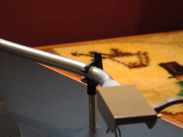

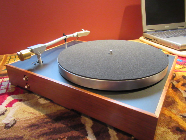

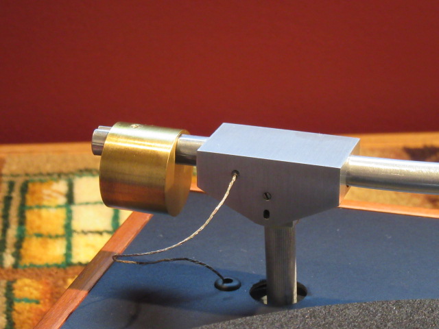

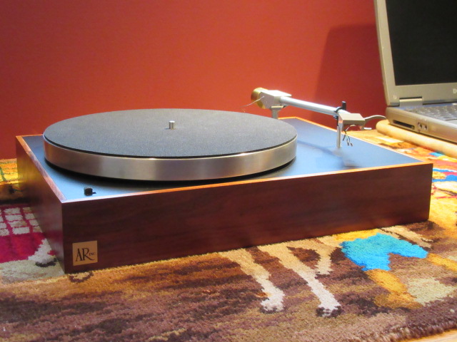

This table has been between Frank's house and mine a couple of times. At one time it was the 2 motor version, now converted to the single, Haydon motor. It is a robust motor for it's size, and seams to work rather well, starting the table rotation in a fairly even manner and keeping excellent timing. I will let you see a few mods that I have done to the deck this time. First off is the removal of the old, worn out interconnects in favor of new RCA jacks. I did keep the original 5 position soldering terminal and it served as a jumper from tonearm connections to RCA outs. The next small change was where the tonearm wires exited the tonearm pivot assembly. The original was a pinch point for the wires, so a new location was drilled into the die-cast housing, sleeved to protect the wires and then 2-part epoxied to keep everything in place. The on/off switch has a new cap, the motor has its original. The head shell has been modded (probably by Frank) that incorporates removal of some the the front part of the box, which allows the user to actually see where he is placing the stylus. I also have used one of my mats which is a close copy to the original AR mat, and (not pictured) a foam block "safety net" for accidental tonearm drops.
The original painted steel plinth has been covered with a black vinyl cover that really hides all of the ills of the old plinth and it is easy to keep clean and easy to wipe off any oil slicks that may have happened during maintenance. Same original power cord, however, new terminal block for power inside the unit.
Sounds wonderful. Oh yeah, I also added a Technics tonearm clamp. The AR tonearm rest certainly did suck.

Wayner, that counterweight isn't stock, is it?
Wayner
Re: Re-restored AR-XA turntable....
« Reply #3 on: 10 Dec 2015, 09:08 pm »
Yep, it is. Why do you ask that?

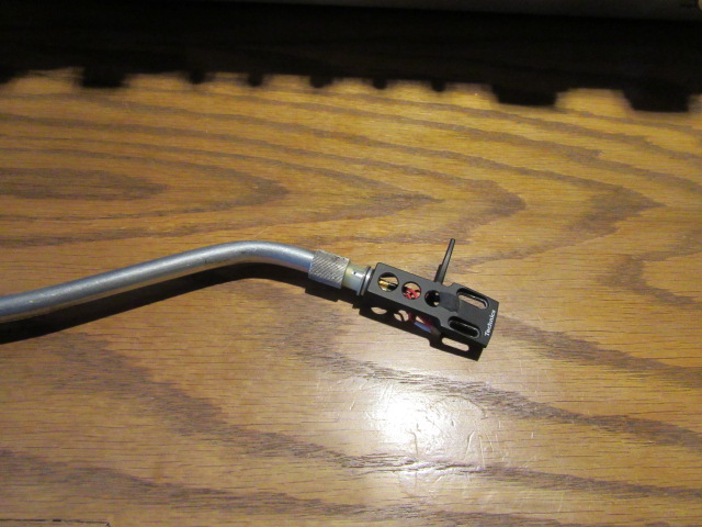

                Your AR inspired me so much I bought a new AR headshell on Ebay to finally get mine going! Fifty bucks, but gold connectors and pins. There is another Japanese wooden headshell for 39 dollars that you should check out that looks more like Frank was trying to achieve. This leads me to a question.
     On the AR-XA arm I can adjust the arm length a little with a small phillips screw. I can also adjust the horizontal angle of the cartridge to the record by eye when I tighten the headshell screw on clamp. But with, lets say a Grado Green cartridge secured in the AR headshell, adjust the angle that the Grado should be on with the start of the record to the end. It might be called azimuth. The Japanese headshell does allow for that. Is the AR arm pre-set enough to not worry about that cartridge angle?

No. This is a failure of the table. While they may have supplied a "pointer" to set the overhang distance, the fixed head/arm angle put an end to any modern cartridge alignment.
I've spent some time on this issue. The AR pointer and the current set angle of the arm put it into no known alignment. It's off by a considerable angle. I have achieved a Lofgren B alignment by placing the stylus in the proper overhang, but had to ream out the mounting holes for the cartridge, so it can be twisted in the head to achieve the correct offset angle.
So, in the end, a headshell that fits with slots is the way to go, and if the slots are long enough, can get you into any of the 3 popular alignments (Stevenson, Lofgren A (Bearwald) and Lofgren B).

I don't know how this head shell is going to fit on an AR arm. The AR uses screw threads molded into the neck of the head shell to attach to the arm via its threaded collar. This model has a single post (like most standard headshells, Technics), and I'm not sure that it would fit correctly....
Wayner
« Reply #16 on: 12 Dec 2015, 09:18 pm »
Mark,
I was shocked when I took one of my Technics headshells and it fit it into the AR arm! However, as I suspected the AR collar will not engage and lock it into place. If you could find a collar for it somewhere, you can snip the arm slot out inside of the arm pivot structure, remove the AR collar and install a normal, regular collar. Looks like the pins will line up too!!!
Wayner
I just twisted the collar over the pin.  The pin is hard, the collar is soft aluminum, so I basically "machined" a deeper groove in the threads of the collar.  You also might be able to file the pin on the headshell a bit to minimize the material you need to remove from the collar.
Sweep up the shavings and you're ready to rock.
