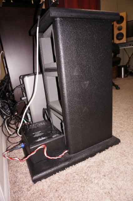

When I built my three 8" driver H-Frames I made the base long enough in the back to accommodate the amp boxes.
Don't know why sometimes pictures import sideways or how to fix it  :scratch:
I was a little concerned about blocking part of the bottom opening but Danny said due to the frequencies involved it wouldn't be a problem.  I'm not totally fond of this arrangement but it does save space.
This is very cool! I haven't seen this one. Do you have a schematic for it?
Mike
   Looks like someone needs some wire management :duh: kidding aside it does make a difference for the good. :thumb:
Mike
I usually lay down on the floor, or the desk if it's big enough..
Re: Assistance with Building an OB Sub Stand
« Reply #10 on: 30 Nov 2015, 09:14 pm »
Mike
There you go man..
I really like how you extended thjat base to creat the space for the amp box :beer:
Early B,
Not really but it wouldn't be difficult to take some measurements if you want them

How'd you get the picture to do that? The picture is oriented properly in my computer but shows up turned on its side when I post it.

The height on mine is 29 1/2". I couldn't get it any shorter, the drivers are as close together as I could possibly get them. Both the top and bottom are 1 1/2" thick.
I'd sure hate to have to keep taking my speakers apart and moving everything to get to a bottom facing amp. Would have to redial in the imaging each time.
Thanks, one of these days I'm going to get the plinths finished  :?
Your computer is probably auto rotating it when it's displaying  it. When I saved the image and then opened it in PS, it was sideways.
