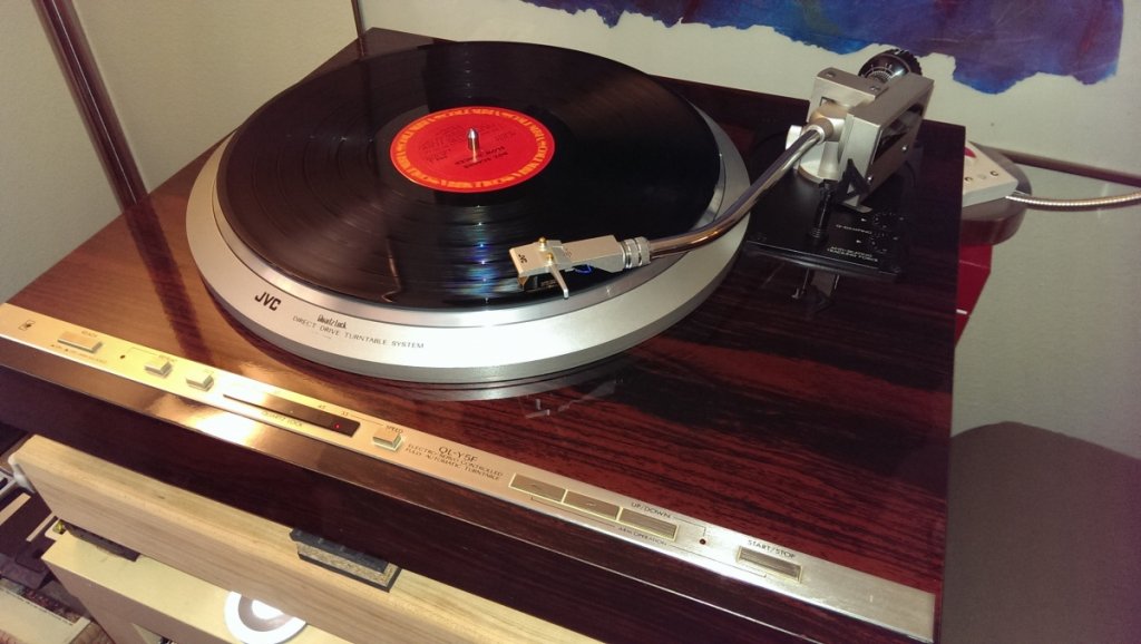

                   JVC QL-Y5F modified with mass loading of the plinth and re-enforced base,
                   AT-OC09ML/II cartdridge
                   JVC QL-Y66F, no mods (yet), Denon SL-D1 cartridge

   The original idea was to compare Jay’s JVC Y5F with the OC09 cart and my Micro-Seiki with the same cart to see how the very different turntables/tonarms changed the sound.  The JVC is a direct drive with the Q-damped tonearm, while the Micro-Seiki is a simple belt drive.  Also, Jay added an extra 15 pounds or so of plastic clay to the plinth, so it was much more substantial.  The best I could do with my Micro-Seiki was put it on some Stillpoint cones.  It’s clear it needs the plastic clay treatment badly.
   We started with the Avid phono pre and the Ultravalve.  With both tables, we could immediately pick up on the cartridge’s signature sound, detailed, very lively, a little tilted up in the mid highs (1-3K maybe?) and slight dip in the bass (maybe 60-70Hz?), though the deep bass was there.
   I’m probably biased, but I preferred the sound coming from the Micro-Seiki.  It had a little more body while the JVC was slightly lean.  I think Jay agreed… I’m sure he’ll comment below ;)…  They both sounded quite good though.

   Next we tried the other JVC turntable.  The QL-Y66F is a beautiful table.  The platter is oversized and gives it a museum quality look.  Lots of electronics on this baby.  It has the Q-dampened tonearm and if I understood correctly, the platter “floats” on a magnetic field?  Anyway, Jay just got it, so he hasn’t packed the plinth yet and I think that’s what we noticed right away.  There was less focus to the sound and it sounded like Rickie Lee was slurring her S’s like crazy.  Well, ok, she DOES slur her S’s… but it was even more pronounced than normal.  Over all the sound was not quite as detailed, but very listenable.  Smooth with body would be a good description.  We decided to switch from the Ultravalve tube amp to the 400R Hybrid amp to see if the solid state would be an improvement, and it was.  Things sharpened up, but I think we agreed the previous two turntables sounded better.  We briefly tried the EAR with the Hybrid amp and that was the worst combo, more peaky, more brittle.  Back to the Avid and Ultravalve…

The most interesting comparison was between your Micro-Seiki B21 and my JVC QL-y55f running the same AT OC9ii cartridge. I agree with your comments about the differences in sound between the two, and I also prefer yours. Lot's of factors in play from the turntable, tonearm and wiring.
My JVC QL-y5f was mass loaded with plastic clay and strips of peel and stick vinyl tile through out the plinth that was described on this site a while back:
 http://www.audiocircle.com/index.php?topic=89320.0
I also beefed up the bottom plate with solid 3/4 inch walnut stips and plastic clay below the turntable and replaced the feet with cork-neoprene footers. The whole unit now weighs 35 lbs. Rapping the outsides of the plinth reveals a nice dull thud. I did not replace the original interconnects, and I wonder if your Furutech AG-12 phono cable was a major factor. I think my next move will be to replace the interconnects. Time to get the soldering iron out!
Since the JVC has Q-dampening, we also dialed the Q-dampening on the fly, and there was no audible difference in sound. The JVC speed is dead on, the Micro-Seiki, has an audible pitch variation with sustained notes mostly likely from a belt that needs to be replaced.
