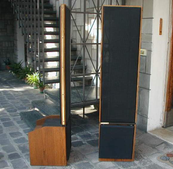

BruceSB
Can anyone outline some of the differences (& similarities) between an Apogee Duetta Signature (or Classic 1.5DS) and a typical electrostatic?
Would be good if you could also comment on ease of positioning also.
Thanks.
Bruce

BTW, Acoustats are not hybrids.
I said it and some of them are.  The Acoustat Spectra 1100 come to mind as an example.
Doesn't that look like a hybrid to you?
Wind Chaser
Re: Comparison of Apogee Duetta Signature to an Electrostat
« Reply #18 on: 1 Oct 2015, 12:02 am »
I had the Model 2 and I remember scratching my head wondering why Acoustat did this?
