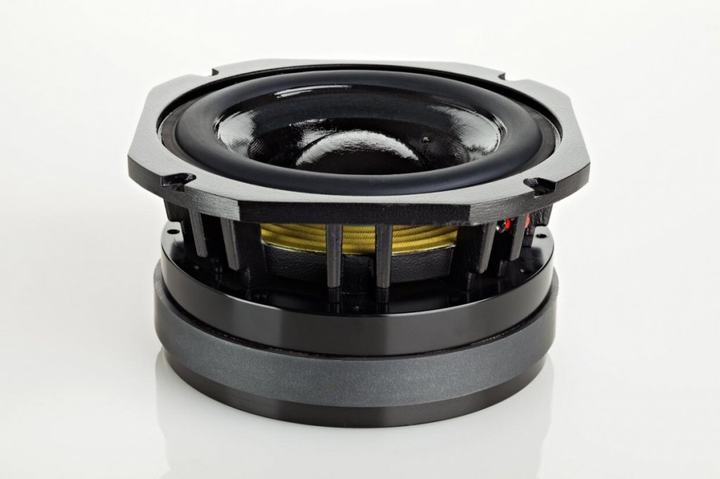

Boy all that seems so right, but the ATC prices are all so wrong ($4990/pair for the cheapest active ATC, the small 2-way SCM20ASL PRO MK2).   :cry:
Considering the sound quality you get from the ATCs I think the prices are very competitive with other speakers in the market. Those SCM20ASLs do need subwoofers for a full range system but sound in one word awesome. The SCM19/20 also measure really well; the mid/woofer is a very clever design, where the outside of the cone decouples from the inner at higher frequencies. Notice the "two tone" coloring of the cone...that's the two different materials in use. Plus the large soft dome dust cap. And the massive underhung magnet!
