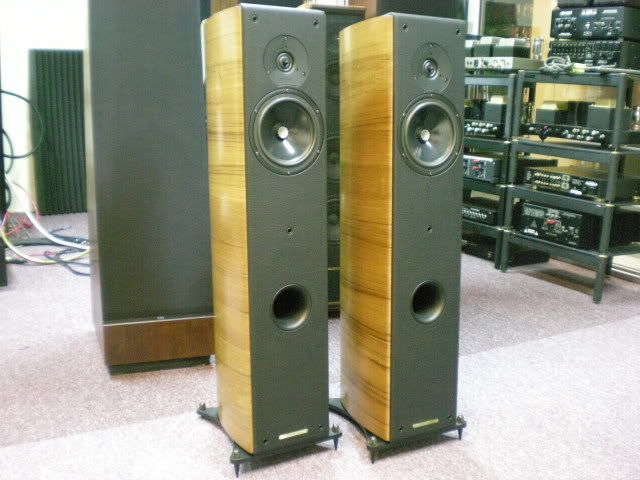

At low sensitivity, 4 ohms, hi price Sonus Faber may be a alternative.
Mainly a used Concerto Domus floorstanding, very transparent sound, bass alot and a small smart xover.
Hi WAF acceptance with real leather and wood finisches.
