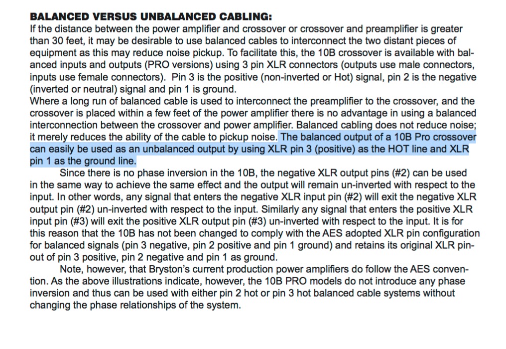

and how to proceed with my 10bsub pro? It has only balanced xlr's...? So no option to choose unbalanced using that?
Marius
The balanced cable (circuits) will add 6dB of gain so the hiss would be more obvious in a sensitive system.  Balanced lines are useful when you run long lengths of cable so at 2 meters single ended will be fine and if it reduces your hiss issue it may be the better option.
james
Marius
You can by using an XLR to RCA adapter cable.
james

Really? Isn't the 10bsub pro a balanced device all together? Switching cables doesn't make it an unbalanced device does it?  :scratch:
Where to put the adapters? Both nn the 10bsub in (coming from the bp26)  and out  (going to the 28b in) or only the latter?
Would this:
imply i need only 2 adapters to the power amp? If so, here to put them: at the 10bsub side, or at the 28b side.
how many db do we cut this way James? the full 6 db difference between balanced and unbalanced, or only half, since we still use the balanced outs of the pre....
Would this:
Marius
Hi Marius
It does not matter which end as once one end is unbalanced the line reverts to single ended.  It reduces it by another 6dB.
james

To be sure: i can use the balanced outs (XLR) of the BP26 into the 10bsub pro, and from there on use the balanced outs (again still XLR) to the power amp, and at the inputs of the 28b's put in the xlr-rca adapter and use the single ended input?
No harm done but reduce 6 db?
Shielding against noise (main reason for me to use balanced cabling) still functional up to the power amps?
btw James, the explanation of the AES XLR regulation concerning the pins
coudn't somehow be the cause of any hiss? Maybe my cable maker was mistaken in this layout, and correcting this might result in a dead silent system?
Marius

Ok James, thank you.
Marius
Correct  :thumb:
