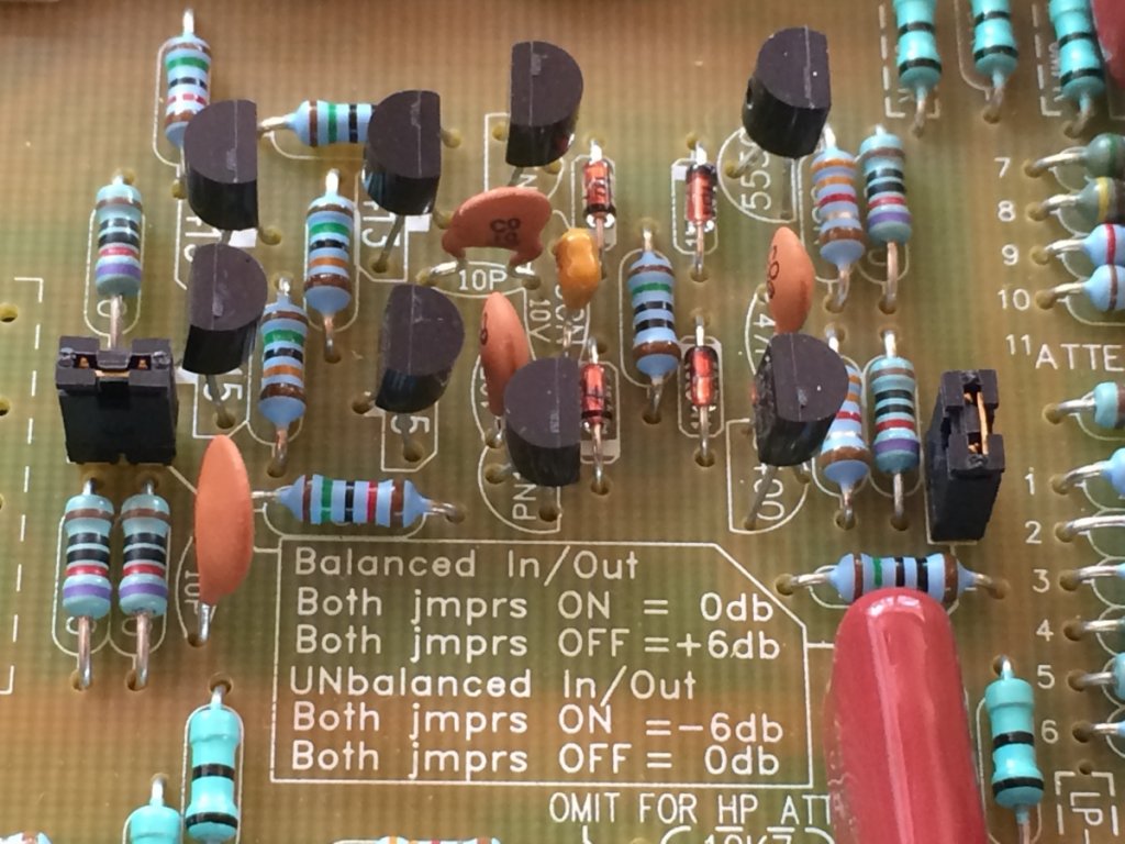

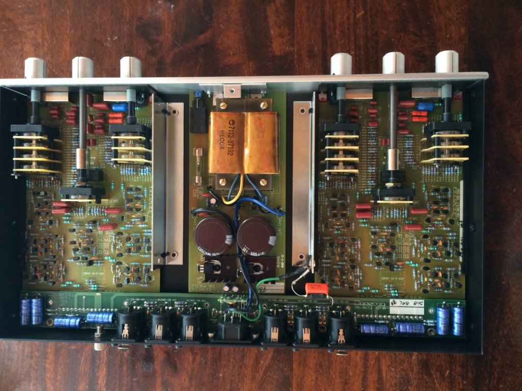

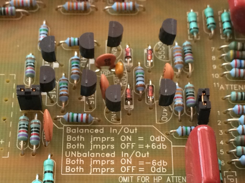

Jumpers are installed, indicating it is already -6 db and the 10bsub can't be reduced any further?
full
left channel
right channel
cheers,
Marius
