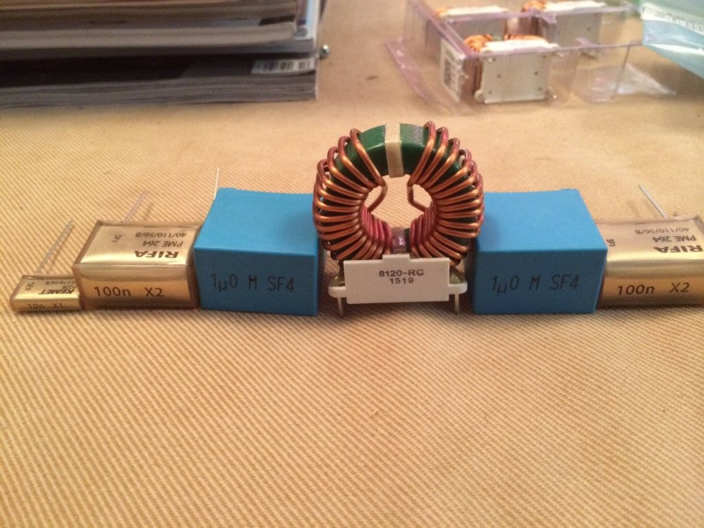

OK. So I bought the below parts to try a Felix with these amps. I might first try them without the coil, then with the coil, to see how they sound. I can probably get them all to fit on the Felix board, with some twisting and turning.
Do these parts look OK?
Occam
Industry Participant
Posts: 2480
Waveform Fidelity
Re: Felix for Tube Amps, What to do?
Reply #12 on:
28 Oct 2015, 07:49 pm »
Syrah,
The parts seem fine, assuming the larger blue caps are X2 or Y2 rated.
I'd think using the 8120 CMC on that group buy board would be awkward, at best.
Its quite easy to assemble a Felix on a perf board and run and solder the connecting wiring underneath.
