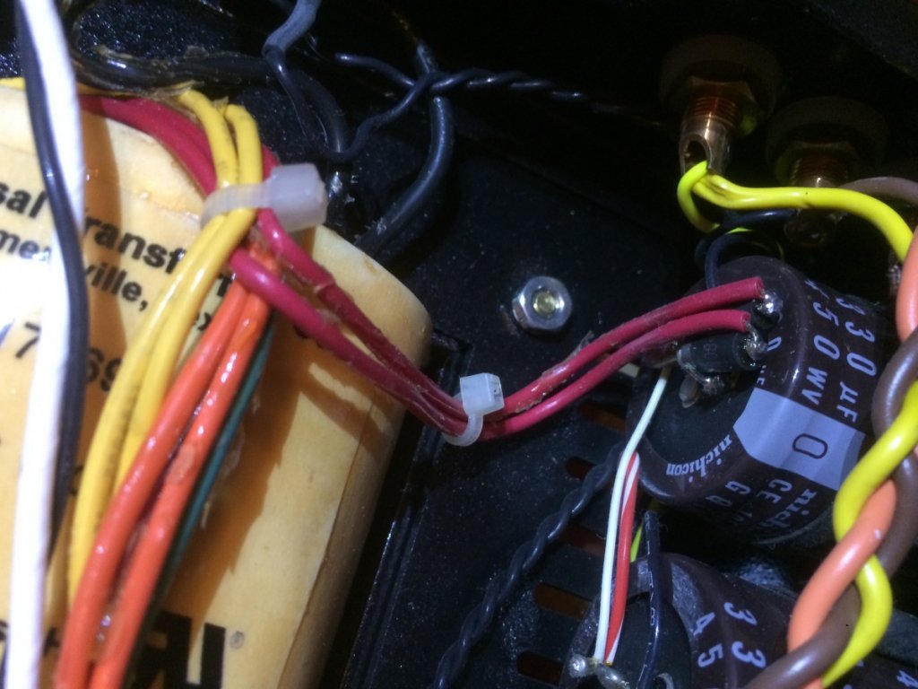

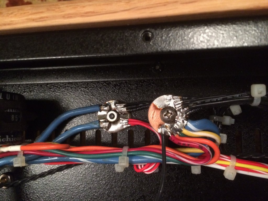

Getting back to the snubber idea.  I'm wondering if I can't give this a shot myself.
Here are a couple of picks from inside the Dodds.  It looks like those blue wires coming out of the transformer are the secondaries?  Then it looks like they're both soldered to those round copper circles.
Assuming that's the case, and I could snap some more photos of the wiring to be sure, the snubber (330 ohm carbon resistor and 0.022uf orange drop cap) would be wired in between both copper circles?
Thanks.

« Reply #33 on: 7 Jun 2016, 05:18 pm »
The red and yellow wires, that go to the high voltage cap banks, are likely to be the high voltage secondaries.  They generate the positive and negative high voltage needed for tubes.
The rings look to be grounds to me, the single point ground.
I would also guess there is a 2nd transformer, to the right of the high voltage one.  Guessing that the 2nd one is for the heater power.  Is the power input on the top left part of the picture, that got cut off?
Do you have a meter to measure stuff?
It looks like there are resistors on the lower high voltage cap bank, so I'm pretty sure there is another set on the top bank
These resistors drain the high voltage after you turn off power.  So, a few minutes after you turn off power, there should be no high voltage, and the amp would be safe to measure.
Just to be safe, I would very carefully measure the voltage across the caps after a few minutes after turning off.   Make sure it is 0, or some low voltage.
Randy

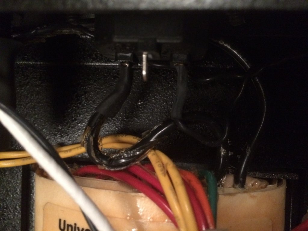

Those two black wires are the mains coming in to the transformer.  Next to them are the green, red, and orange wires coming out of the same side of the transformer.
In the other photo you see the red wires going into the first caps on the one side of the amp.  The similar cap on the other side of the amp is connected to yellow wires which seem to go to the IC.
I can try to trace those orange wires, it looks like one of them goes to another cap at the end of the row of caps that the red one is plugged in to.
If that is a resistor on the caps, it’s a funny looking one.
That other transformer in the middle must be an output transformer.
What do you think?
Could it be that red and orange coming out of the transformer are my DC + and - ?

Re: Felix for Tube Amps, What to do?
« Reply #38 on: 8 Jun 2016, 03:24 pm »
I think you're right, the other transformer is likely an output transformer.
The black things on the caps are diodes, they are rectifying the voltages to generate a DC voltage.
There are multiple outputs from the power transformer for a tube amp.
Need heater power, B+ (high voltage), and maybe another high voltage.  In thinking about it, not sure if there is a negative high voltage or not, there may be two different high DC voltages generated.
Hard to tell by looking at pics exactly how things are connected.
One thing you could do is get the part number of the transformer.  I think it starts with 17 but the rest is hidden under wires.  With the part number, you can find the transformer data sheet, and that will tell you what the different wires are.
