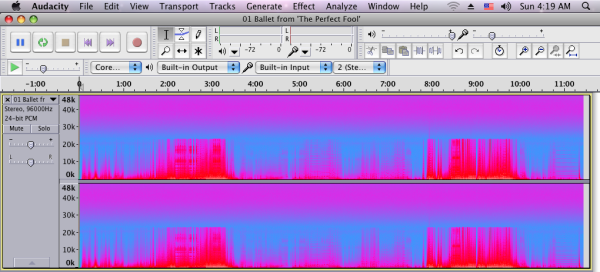

The above image is a spek generated spectrogram of a 24/96 file with clear ultrasonic content above 24kHz indicating that this most likely has the 24/96 mastering claimed.
Image Below From Positive Feedback   Audacity generated

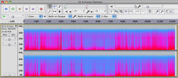

Here is a spectrogram of a 24/88.2 music file with authentic ultrasonic frequencies.

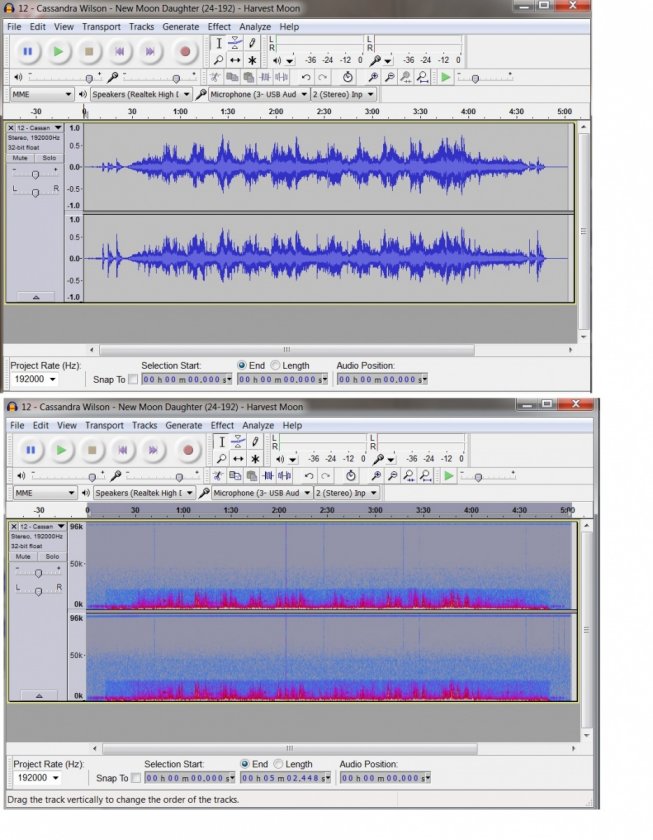

I have a question on Audacity, hope it ok to ask here. I want to make playlist of songs to do AB comparisons with,I only want 1 min of each song, I was going to use Audacity to edit the music but it appears that audacity is limited to 16 48 and I would like at least 24 196. I’m i wrong on the limits of Audacity? Is there and editing program that will do 24 192.
ted_b
  • Posts: 6345
Re: Spectrographic Analysis of "Hi-Rez" Downloads
« Reply #9 on: 10 Aug 2015, 04:26 pm »
Audacity can handle 24/192 files just fine.  Here is a screencap of the waveform and spectrum of a 24/192 FLAC Casssandra Wilson cut from New Moon Daughter.
