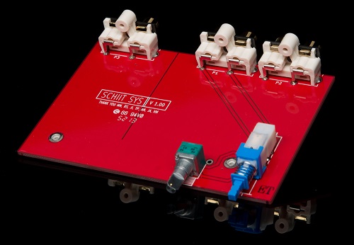

I wonder what is in the Emotiva or Schitt VCD other than a potentiometer ? Can't be much more at that price point
« Last Edit: 2 Aug 2015, 02:19 pm by KR500 »
srb
Re: Volume Device Plans
« Reply #17 on: 2 Aug 2015, 12:31 pm »
I wonder what is in the Emotiva and Schitt audio volume Controls other than a potentiometer maybe ?
Just a potentiometer in the Schitt SYS.  I would imagine the same for the Emotiva Control Freak and the TC Electronic Level Pilot.

 Steve , I just checked the company site
Guess I needed the second cup of coffee this am to make that leap
Davey
  • Posts: 1481
« Reply #19 on: 2 Aug 2015, 02:00 pm »
The Schitt is a 10k control.  I have one of those too.  :)
It doesn't have the same excellent left/right channel matching of some others I've tested, but there may be some unit-to-unit variation.  As usual with these, if you get the rotation near 12 o'clock and higher the channel matching is much better.
A nice little box with two inputs for $50.  You really can't beat that.
