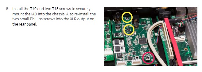

I received my IAD kit on Wednesday and replaced the sound card last night (Thursday).
Overall, everything went very well but I did not get the chance to audition the upgraded sound card.
Going through the instructions, I had an issue with Step 8 (see below).  When it came time to install the T10 screw in the "elevated" bracket of the IAD (red circle), I could not find a single screw that was long enough for the installation.  However, I did noticed that with the two T15 screws (yellow circles) the new sound card is well secured, so no big panic.
One suggestion I had for Bryston, when putting together the kit (very nice kit), is maybe mark the bags with the screw sizes since I really do not know what a T10 or T15 screw looks like.
By the way, I also had some grief with the Phillips screws on the XLR connector.  Maybe these should be replaced by either Torx screws or Robertson screws since they are real tinny and need a good grip to be reinserted into the new XLR connector.

I would kindly suggest you go back to Step 7. The chassis screw boss needs to fit through the hole in the IAD and into the screw bracket. I found it takes a little time to make sure alignment is perfect. The T10 screws provided are of correct length if the chassis screw boss is fitted properly through the the hole in the IAD. The 3 point mounting makes the IAD much more secure.
I do agree the Phillips screws anchoring the XLR are snug. Otherwise I found the IAD install straight forward.

Ned, you're right, looks like I completely missed that part from Step 7.  I'll take a second look tonight.
