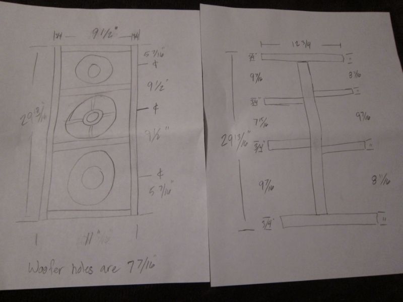

I'd think someone  who's made / built the triple  8's will chime in with some  exact measurements....
Looking quickly at the Rythmik site I see the 8" drivers  have an 8.78 OD  and need 5"  of  clearence.  If you made each "box" front and beck  approx 10 x 10 x 5.5-6 you'd be fine.
I'd  still double up the side panels, tops, and bottoms.  A single layer baffle and the 4 braces will be fine
So using a .75 thick baffle  / braces,  you'd be lookjing at 31.5 tall by  11.75 - 12.75 deep   then  your top/ bttom plates
Of course if youi're doing doubles,  shorten  the height up  to 20.75".  Also, I didn't  tagger the braces like some do, you could save a bit more height by doing that
You could probably open that 10"  x 10"  a little bit if you wanted a little  more clearence....

« Reply #22 on: 11 Apr 2015, 03:25 am »
Hey Guys,
I will draw some plans and post them here tomorrow. I've got it all laid out full scale. I just need to pull the measurements and draw it up.
Ruben

« Reply #39 on: 17 Apr 2015, 03:06 am »
Hey Guys,
Sorry for the wait. I had to lay it out again from scratch as my original layout was done using 1 1/4 inch MDF everywhere. This scribble will give you the essential dimensions and you can account for additional material thicknesses as you desire. 1 1/4 - 1 1/2 inch material thickness is recommended for the top, bottom, and sides.
Not shown in the pic, but the drivers are centered left to right. 5 1/2 inches from the outside face of the side panels is centered. The baffle is also 3/4 inch thick as drawn. Braces are 6 inches deep.
Best,
Ruben
Here is how they look when built using 1 1/4 inch material for all parts.
