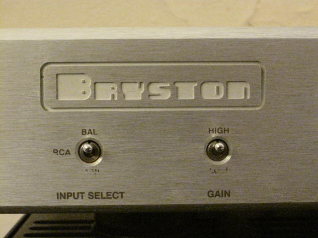

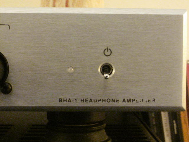

Curious if anyone else has had the silk screened type on current  dress panels on newer units not holding up over time as the older face plats did.
My 2.5 year BHA-1 is losing the black type on its silver front in numerous places and was never a problem on any of my previous Brystons including the BP25P, B60R SST or remotes or even the older .5 and .4 preamps even after many years of use.
I’ve contacted Mike but thought I’d do some preliminary research while I’m waiting to hear back and see if it is a current problem maybe with just the silver and not black front panels, it’s only cosmetic but still…?

Mike did get back to me and mentioned it should definitely not be coming off… so instead of babying it I just tried gently rubbing my finger across the type and voila… so obviously something did not take.

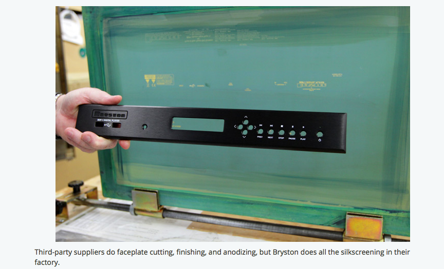

Something Bryston might want to consider is a process we use for faceplate text and graphics that can never wear off.
It is a double anodizing process unique to our metal finisher, Nor-ell of St. Paul, Minnesota.
The process first anodizes the background in one color, with the text and graphics masked with a wax formula preventing the anodizing process from affecting these areas.
Then the wax is dissolved, a new wax screen is applied masking the first background color completely and then the panels go through the anodizing process again with a different color.
When this is completed, the second wax resist is dissolved and presto, we have a finished panel with the text and graphics now a separate finish color that is now part of the metal and can never be worn off.
For a company with a 20 year warranty, I suggest this would be a good low cost improvement to make sure the finished external panels markings last perfectly for 20 years too.   :)
You can examine the result of this process with any of our products built in the last 30 years or so.
By the way Nor-ell can do this process in any color and even with images.

http://www.soundstageglobal.com/index.php/company-tours/bryston-august-18-2011/170-manufacturing
