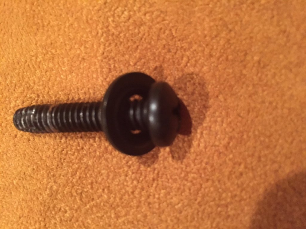

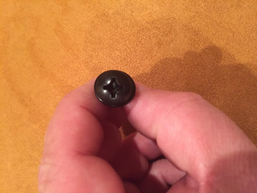

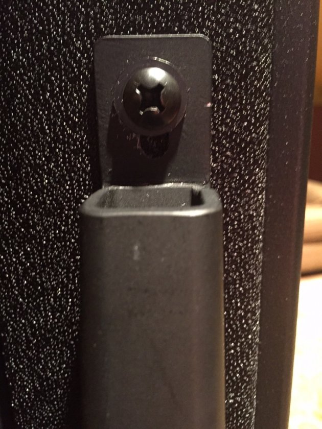

Excellent discussion. The hardware between my 3.7 and 3.7i are clearly different. The 3.7 were cherry wood and the 3.7i are black aluminum. So, I attribute the difference between wood, which gets wood screws and aluminium which gets machine screws, not 3.7 vs. 3.7i...
Grant,
The slots in the supports that attach to the back of the speaker had to be enlarged to fit the machine screws. I used a dremel tool and it only took a few minutes.

That's probably it, my 3.7i are dark cherry, seems likely the aluminum frame would use machine screws.  An advantage construction-wise in my view.

The wood screws goes right through the MDF and grip into the solid wood strips on the front. I have not found any srewa that grips into the slap of MDF. The feet are screwed into nuts inserts. I am refering to the 3.6. I think it is the same for the 3.7 or 3.7i.
The aluminium over MDF may have a thread for machine screws in them but it is just 3-4 mm of aluminium, do not overtighten the screws.
