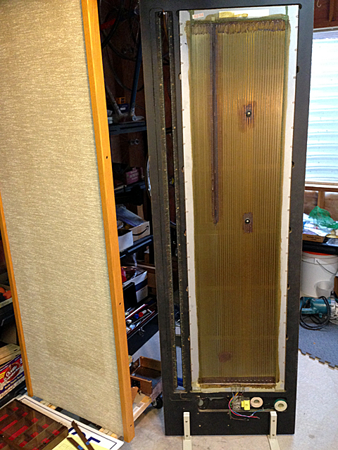

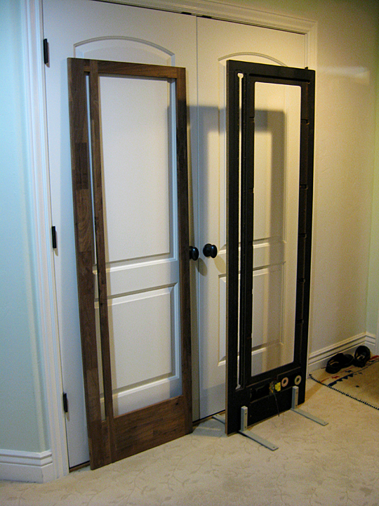

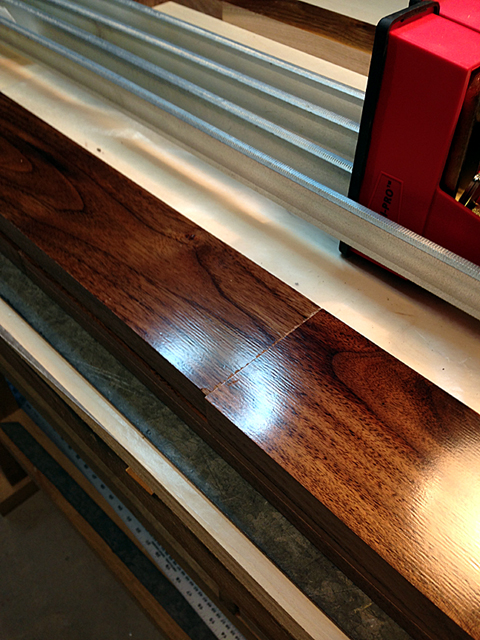

I have a few pics and thoughts:
Here is the progress of the base frame.

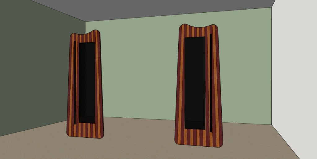

And my rough Sketch-up.
And a crazy idea I played with.

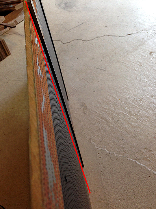

After I removed the grill-cloth from the IIIa's and began to look closely at the various construction techniques, I noticed that there were no fastening points at the bottom and top.
At first I thought, "oh that's not very good," but then I saw that the panel is actually curved.
I don't know if this is designed this way or a deform that has developed over the past 30 years of living in different relative humidity.
It's a good way to ad some strength to the panel, and I've also read that it's used to prevent the panel from slapping.
No matter, I've got to accommodate for this.

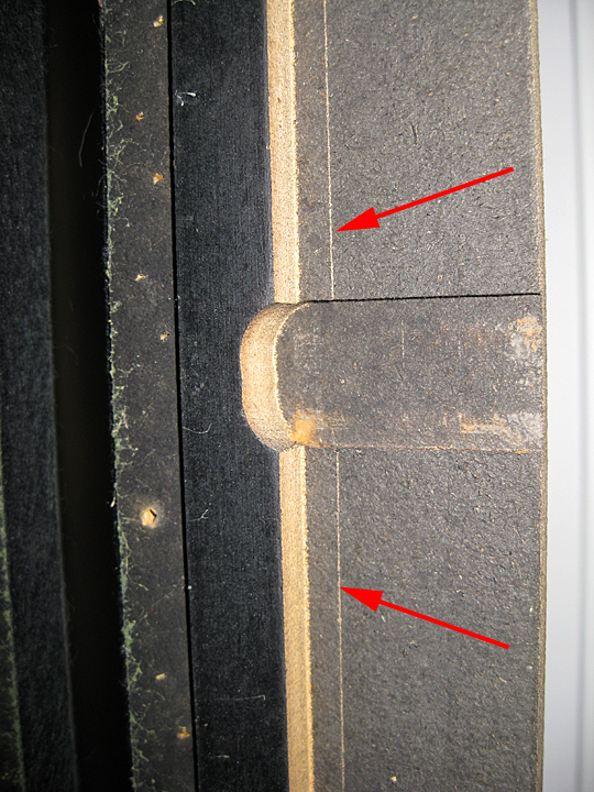

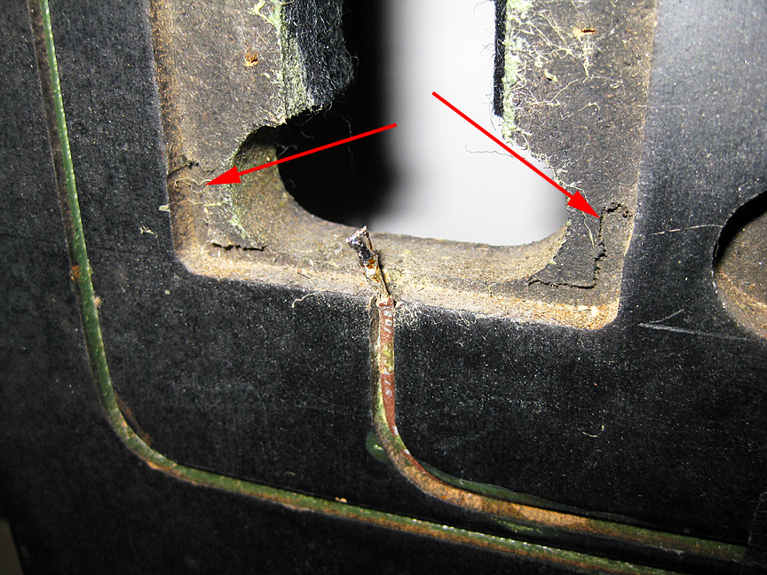

I also noticed that Magnepan added a little bulk to the area where the panel rests under the staples.
I am wondering why these router cut-out were applied.
They are at the top and bottom of the ribbon.

I hope everyone appreciates the design of that "sandwich" construction.  The objective is to yield even contact on the total perimeter of the transducer unit, but not have a death grip on it.  It needs to be able to "float" within the sandwich.  The first two MUG users who attempted to duplicate my scheme completely misunderstood the concept.  :)
The transducer contact area should have the black paint sanded to generally smooth it and also remove any paint ridges from the initial painting at the Magnepan factory.
The pocket screw joinery works fine and is very easy to implement.  My speaker reframing was completed in 2009 and the integrity of the transducers and frames are still perfect.
The bend in the transducer units is normal and should not be "straightened out."
Dave.

Yes, the panel should not rattle around within the sandwich, but it should be held securely enough to allow wood changes with temperature/humidity to not exert problematic forces on the transducer unit.
I think your idea of using Teflon tape is probably an excellent one.  I think I would apply the tape to the transducer unit and not the wood pieces.
Regardless, the critical part of the project is the spacer strips that create the proper gap in the sandwich.  Those should be almost the exact thickness of the transducer units.
Dave.
