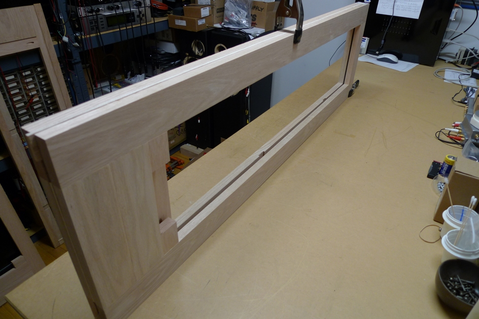

Regards the MMG frames:  This is probably the best single photograph.  A couple of temporary clamps holding the two halves together and you can clearly see the gap created by the sandwich construction.  Note the little notches to accommodate the transducer cross-braces.
Dave.

I remember seeing that picture some years ago. This is exactly what I am looking for. If you will post more pictures I would appreciate it very much, although the one picture probably tells the most essential stuff...

If the Polepiece is slightly curved, I guess along the top and bottom sides, what happens when we place the panel inside a sandwich frame which seems to suspent the panel equally on all 4 sides? Will we not then strech out the Polepiece curvature here?

The curvature of the panels is minimal, and framing them in this way does not alter it.  The clamping pressure should be light (and only on the edges) so it doesn't really exert any straightening force.
The thickness of the spacer between the two panels is fairly important since you want decent contact between the panels and the transducer unit.....but you don't want a death-grip on it either.  I did some smoothing with sandpaper on both sides of the transducer units to give them a smooth surface.  The black paint can be somewhat thick and runny in places, so it's good to smooth it down.
These speakers were completed in 2009 and have been in semi-regular use since then with no issues regards performance or longevity.
